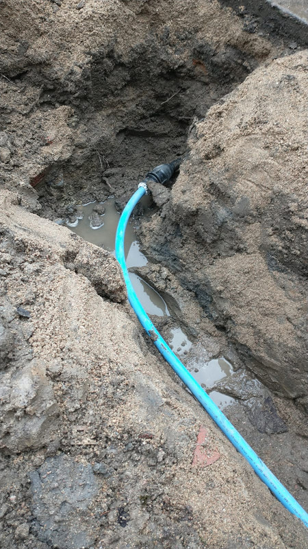

My watermain burst.
The emergency plumber showed up and said oh the waters all ready off a the main the leaks stopped ....I'm off toodle pip.
So trying to get the water back on.
Rerouting the water from whence it leaked under a concrete slab (another story about how the insurance company were going to dig up the slab to repair)
How ever what I have is old black poly pipe.
Measuring about 26.8 or a shade under 1 and 1/16th. Od
And c' 21mm Id
It had a compression fitting on but obviously I have no olive and it went direct 22mm copper.
Trying to go to blue water pipe.....but at this stage I'll convert from that black pipe to anything to get the water back on so the girls can come home.
Going to the merchants in the morning but it would be nice to know what I'm looking for before I start. Google's not throwing anything up.

https://www.bes.co.uk/pipes-tubes-fittings/pipe-fittings/mdpe/water/compression/25-mm-x-21-mm-27-mm-bent-universal-transition-fitting-polyfast-13549/
Found these which would likely do......but would you bury it out of site ......although at least if it does go again it'll only flood the garden....not the sodding dining room.

alkathene pipe or MDPE fittings are what you need
If you can take a small piece of black pipe in with you to be sure what you're buying fits what you have

Yeah that's what I'll be doing..... Been through all the fittings in bnq doing the same tonight with a bit of the pipe.
According to Stevenson plastics it should be a 3/4 black alkathene..... But that doesn't seem to correspond to a 3/4 fitting

https://www.bes.co.uk/25-mm-x-3-4in-polyfast-mdpe-reducing-coupling-metric-to-imperial-compression-12842/?ref=gs&gclid=Cj0KCQiA4L2BBhCvARIsAO0SBdaPwmhpWGpIy9Q8N90zHyiOHfmBCXKlTzfsLt6W580YDopgibAMBckaAiZ6EALw_wcB
So this should do ? I don't like things described as universal as per my first link..... Nothing universal was ever good. Not even universal soldier .

Try screwfix or plumb base if you've a local one

Universal or transition coupling. Philmac or plasson are the best makes. They work on outside diameter so you should find something.

Screwfix was no use.
Toolstation was no use.
Tomorrow morning is PTS , plumb base , plumb store

I don't know about fittings for alkathene, but most types of screwed pipe fittings have nominal dimensions that are not obviously related to the dimensions of the pipe.

+1 for philmac here. There's a couple of estates round us that are all plastic from the 70s. Bloody nightmare. Brittle and thin walled...
Rip it all out is my advice!

Well it runs the length of my garden under the concrete drive under the garage under the patio . Not really an option

Cheers plumberists for putting my mind at ease on.the universal joints.
We have water back on and it's routed far better.
Even when I got a response yesterday insurance still want to dig up the dining room floor slab. - no one needs that. They don't need the cost and I don't need to move out for 2 months or more. They need to lift the floor and bring in proper dehumidifiers and dry out the slab good and proper before laying a new floor. Thankfully the sub floor under the house has dried out almost fully. All the standing water is gone and it's just damp rather than saturated.
Hopefully the assessor on Thursday is much more pragmatic especially now that the water is back on and routed sensibly.
Will leave it open for a bit to be sure it's not leaking then bed the pipe and joint in sand and backfill.
