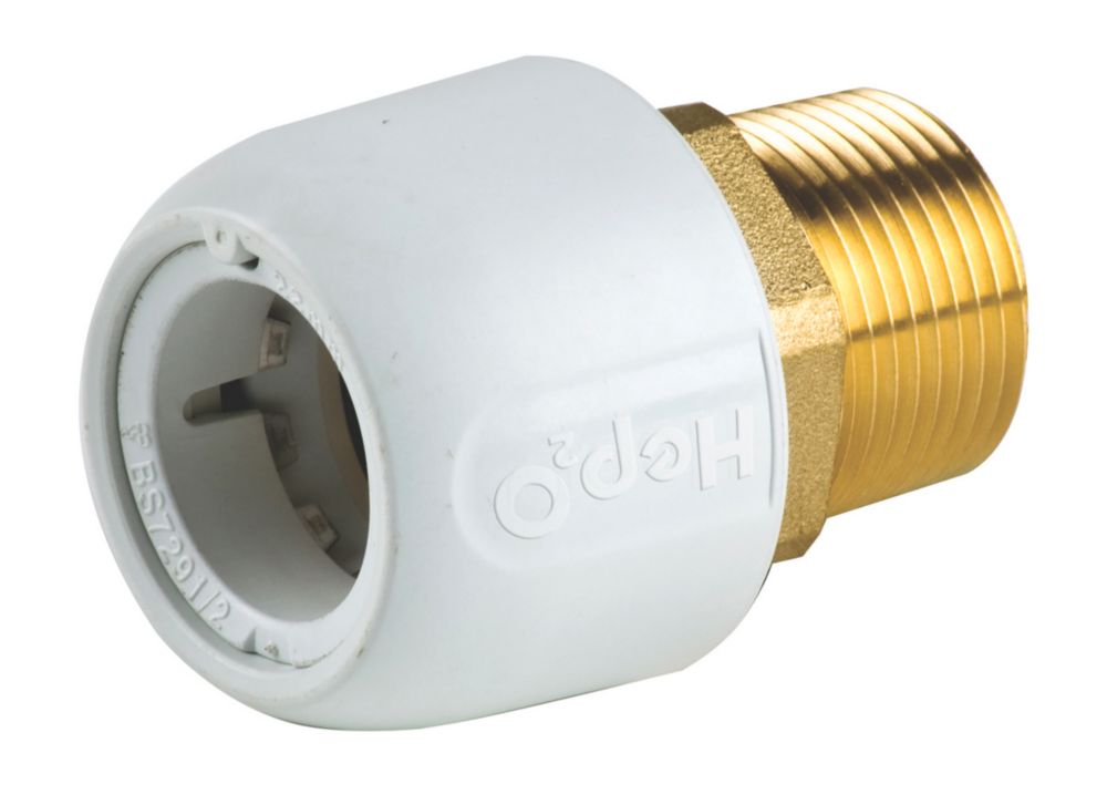

Sorry, male connectors.
Yes to the next query.
are there various different pushfit makes and all have their own peculiarities and different tools?
Yes, but they all fit on to 15mm copper.
Hep2o is the only make that needs a demounting tool. In fact, i can get the fittings off without it, just need 2 flat screwdrivers. It's just a ring like the one on your bends except it's hidden inside the fitting.
Here's the other side of the hep connector:
Posted : 05/02/2018 5:42 pm
