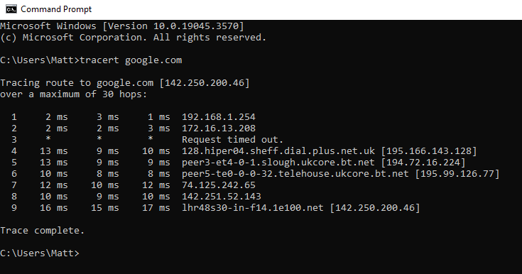

Posts: 15068
For example:
trace
Posted : 05/11/2023 7:17 pm

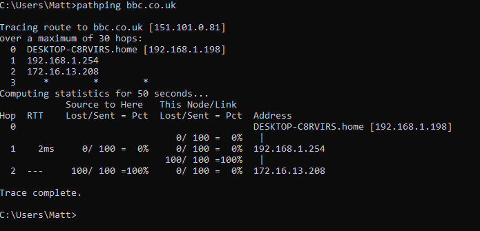

Posts: 15068
But If I pathping something more 'local' like bbc.co.uk..., there's only about 2ms latency.
beeb
Posted : 05/11/2023 7:32 pm

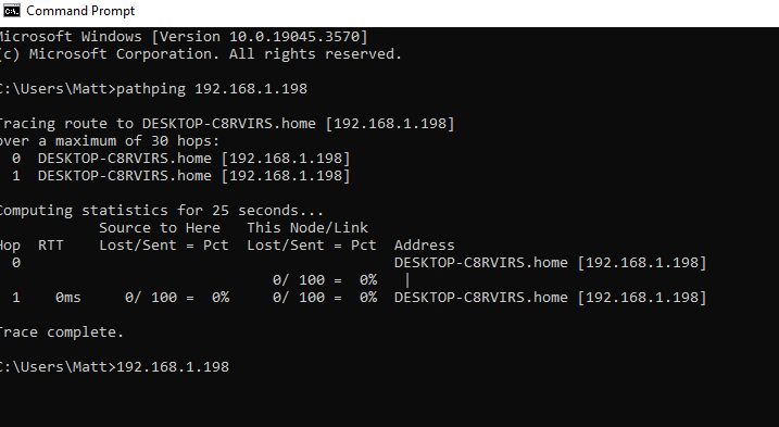

Posts: 15068
If I ping myself, I get zero latency, which is as expected 😉
home
Posted : 05/11/2023 7:51 pm
