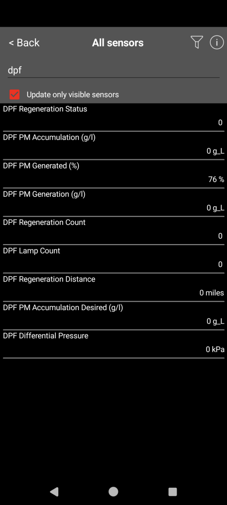

So this obd reader, can I buy a cheap one and leave it running whilst driving? Then look at the data? Or ???
Deal: Foseal Wired OBD2 Scanner, Plug and Play OBDII Code Reader, Car Diagnostic Tool for Vehicle Engine Fault Code https://amzn.eu/d/jexzwWI
Posted : 26/07/2023 6:53 pm

@BoardinBob what reader did you use
Posted : 26/07/2023 7:00 pm
Posts: 14711
<p style="text-align: left;">Just a generic cheap one from Amazon and I use an app called Car Scanner Pro on android. Plug the scanner in, open the app, onnect the phone to  the scanner then youve got a ton of data available like this</p>
Posted : 26/07/2023 7:50 pm

@boardinbob
Bought the reader and got the app
This is what came up!!
Now what??
Car Scanner ELM OBD2
Version: 1.99.4/400994/GP
DTC report
Connection profile: Peugeot OBD-II / EOBDDate: 8/2/2023 8:41:05 AM
OBD-IIOBD-II
DTCs: 1
P1442 [0x1442]
Evaporative Emission Control System Leak Detected
Evaporative emission control system Leak detected  EDC15C2-Quantity of additive Additive ECU.
Status: Pending fault present
Engine control unit#1Engine control unit#1
DTCs: 1
P1442 [0x1442]
Transmission control unit#1
No DTC found.
Posted : 02/08/2023 8:49 am
Posts: 6513
Reset/clear the fault DTC, drive it round for a bit and rescan to see if the DTC has been flagged again. It might have been the garage didn't clear it.
