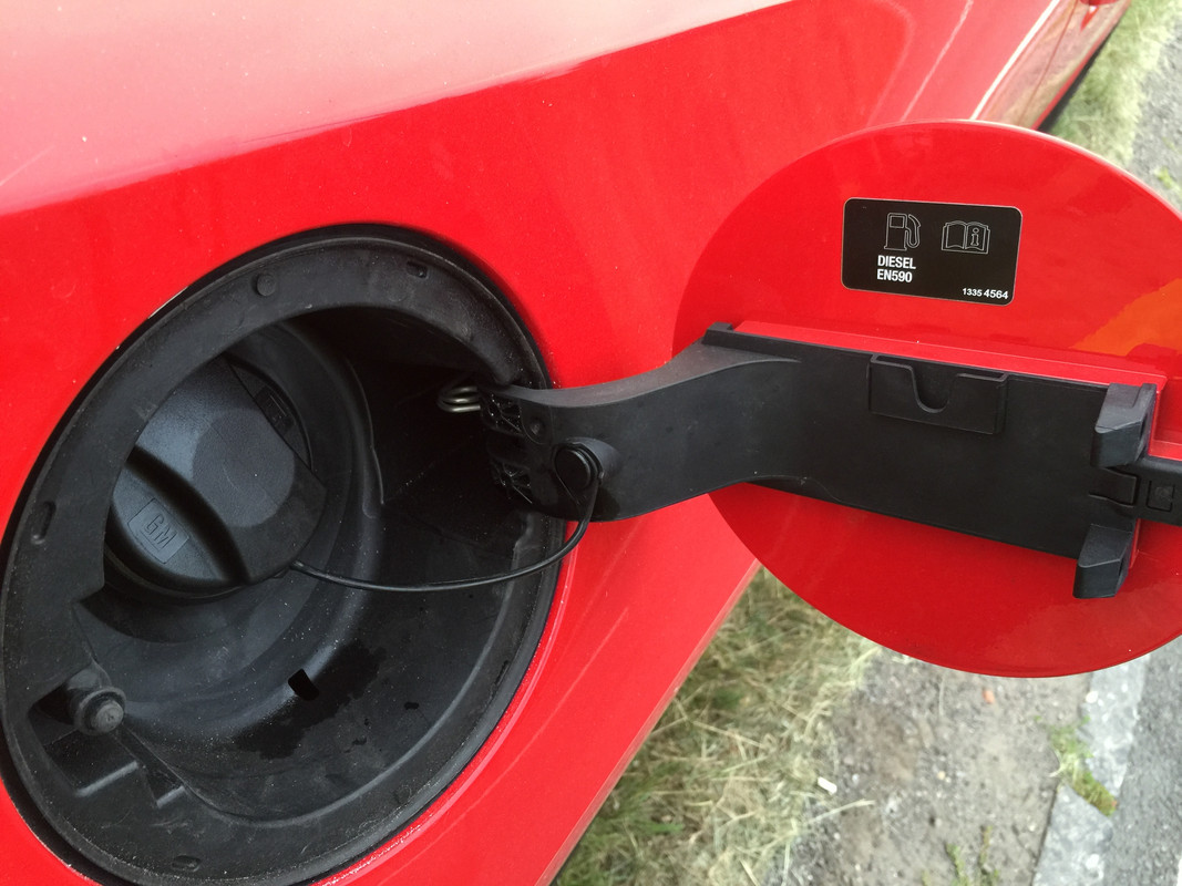

The nozzle on a diesel pump is larger than the filler on a petrol car, so it could be easy to put petrol into a diesel car, the nozzle is smaller than the filler.
I did manage to put £18 worth of diesel into a petrol car once, though!
I had to fill up an Astra GTC, first time I’d ever driven one, and there was only one pump available, which required that I stretch the hose right across the car, and the mouth of the nozzle would only just touch the filler entrance, so I carried on and filled it up.
Now, you might ask, why did I not check to see if the car was diesel or petrol first; I did, first I looked at the tacho, which showed a redline at about 5-6k, diesels are about 4.5k, so not sure, the clincher was the little black label stuck inside the filler flap that said diesel...
The breakdown bloke who came to pick up the car from where it had stopped about a mile away had never seen anything like it, and it saved me from a £250 bill from my employer!
And here’s the proof...
