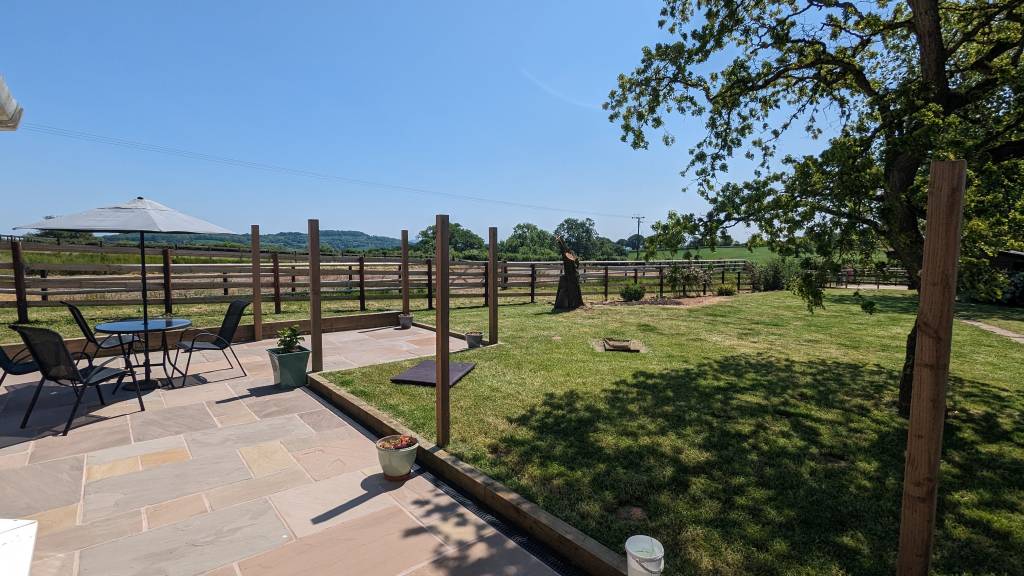

I like a good project and I've also got short arms and long pockets, so i had a crack at laying a new patio here. Roughly 65mtr2 indian sandstone with sleeper borders, decent fall into a channel drain, plus cable ducting underneath for lighting.
Dug the old one out and made bigger, the prep work and sub base was by far the largest bulk of the work, took 4 or 5 weekends to get the shape and base ready (150mm crush n run compacted in places!). Slabs were laid on full wet mix with slurry'd backs still took some time though. Realistically 10mtr2 a day mixing my own in a mixer from bulk. Don't ask about the pointing....
Pavingexpert above is an absolute godsend, wouldn't have even contemplated it without that. Just don't put a time frame on it, or at least don't underestimate the work required.
Oh and keep your eye out for bargains,  I got all the slabs in a sale for £450!

From thisFrom this
Posted : 19/07/2023 10:52 pm
Posts: 1005
To this
Posted : 19/07/2023 10:54 pm
Posts: 3315
Nice effort.
Take it you installed deck posts then changed your mind?
Posted : 19/07/2023 10:57 pm
Posts: 1005
Nope, the 4 around the square but is for a pergola/roof thing, when I get round to it.
I was going to string lights across from there back towards the camera but now I'm not sure, so might cut them off.
All the posts are dug 2ft into the ground so they also support the sleepers to stop them creeping.
Posted : 19/07/2023 11:11 pm

and question for you fettlin - how do you stop water pooling on the edges of the patio against the sleepers?  Or is that not an issue?

@DT78, thanks, it was (and still is!) a lot of work, but now we can see the view it's worth it.
Pooling isn't an issue, all the slabs slope down to the drain, so there are 4 different falls in there! Works better than I expected tbf, but again it was a lot of prep work to set the levels. I nearly ran out of fall working back to the far wall of sleepers.
