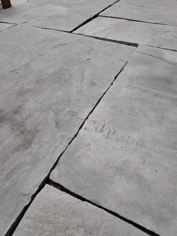

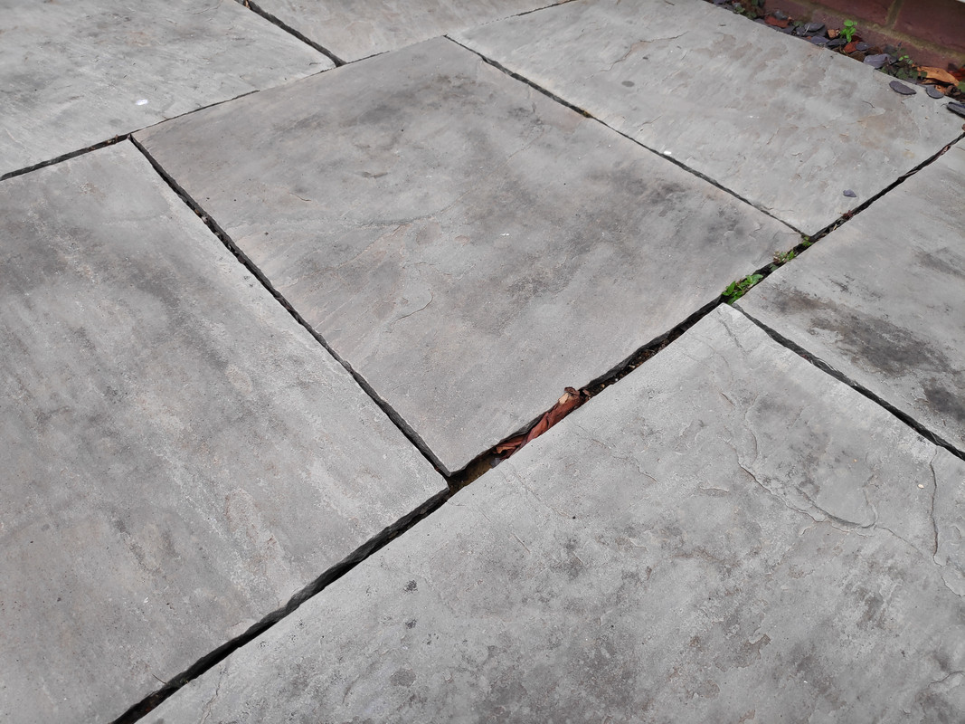

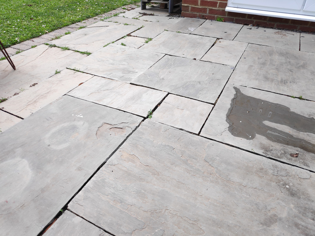

Hi all. My patio is pretty uneven. I think the guy who laid the slabs the last time did a pretty bad job (ok, it was me). The slabs are a little riven, so don't have a perfectly flat underside. I laid these on top of the original patio base which I think is ok. I recall just putting some big blobs of cement under each one.
How should I redo them?

Assuming they will lift okay, just lift, remove old dabs and relay them.
If it was me I'd also point them up to stop the weeds growing through.

(When I say 'relay them' obviously I mean relay them with new dabs and put plenty on. However you *may* end up with the same issue. Unfortunately I think it would be very difficult to do a proper job without lifting the whole lot and laying a proper solid base.

I've got similar and they're a pain in the arse, pretty much impossible to get them completely flat, but use a plank of wood to span others with a spirit level on top to get them level ish....
Use a bit more mortar than you think as it'll all spread out beneath the slabs and give a better bed.

Not sure what your slabs are made of but I laid a porcelain slab patio last summer.
I had a compacted 100mm of aggregate (100mm after compacting) as my main base - spent ages with one of those petrol compacting tools - quite fun actually.
Then I laid a wet mix mortar under the whole slab using a slurry on the back of the slab to make sure it stuck to the mortar (porcelain isn’t porous so it needs the extra slurry).
If your slabs are porous then if you have a decent hardpack layer of something under them I’d do a full wet bed rather than just dot and dab I think.

Full bed is better IMO. Less to move and cause unevenness. Basically spread down a full bed of mortar, then plough grooves into it to allow it settle nicely. Tap the slab in to level it and it should stay there. You do need to get the amount of mortar right as it won't settle that much but after a few slabs you'll have the measure of it. Using the old base should be fine as it'll be well compacted.
