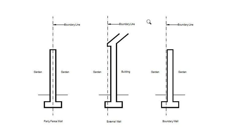

The below image suggests if its on their property & our building does not attach to it then it is NOT a party wall.
https://www.mypropertyguide.co.uk/uploads/images/Party_Wall_Type_B.png
This image also suggests its NOT a party wall & describes it as an External Wall, though there's no explanation as to who is responsible for an external wall.

It forms part of the neighbour’s extended kitchen, is entirely on their property & does not connect to our building at all.
I think your neighbour may have misunderstood what a party wall actually is. It's their building, on their land. It's entirely theirs in terms of costs of repair, and your only involvement would be giving permission for works to be carried out from your property.
If you were building onto the side of it, or near it, then it would be considered a Party Wall, and you would be responsible for making sure your works did not compromise it. If you are responsible for its deterioration and poor condition, then you'd be responsible for making good.
Basically, they're trying it on.
My advice would be to let it fall down, then empty their fridge.
IANAPWL, obviously.

Posts: 7751
Not a party wall.
Based on your comments about their past behaviour, any goodwill has now been exhausted.
It's fully their responsibility with all associated costs.
When it falls into your garden/yard, invoice them for loss of amenity.

FWIW (I am a retired PWS), I would say it's not a Party Wall if it is located on the neighbour's land, unless the OP has "enclosed upon it" with a building. It is the neighbour's responsibility to maintain it, and they may be able to invoke the Access to Neighbouring Land Act to gain access to it from the OP's side of the wall for the purposes of repairing or maintaining it.
