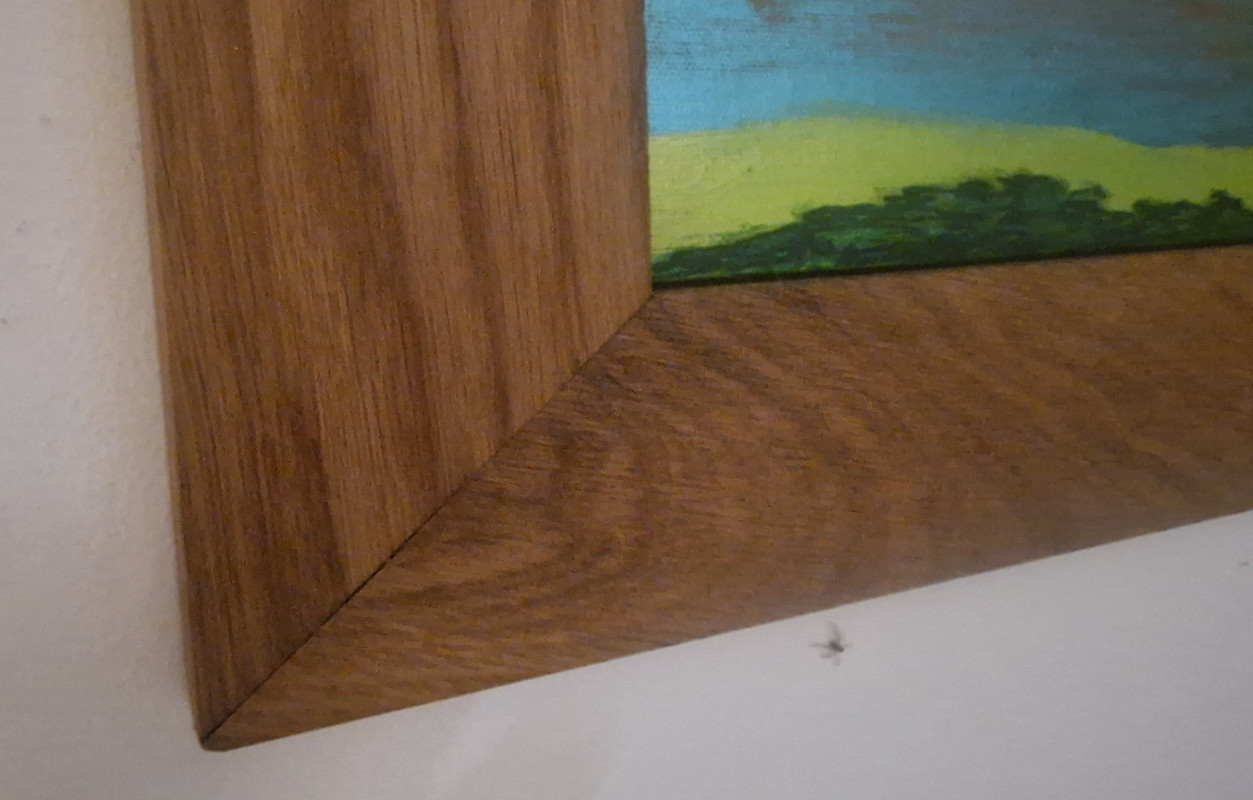

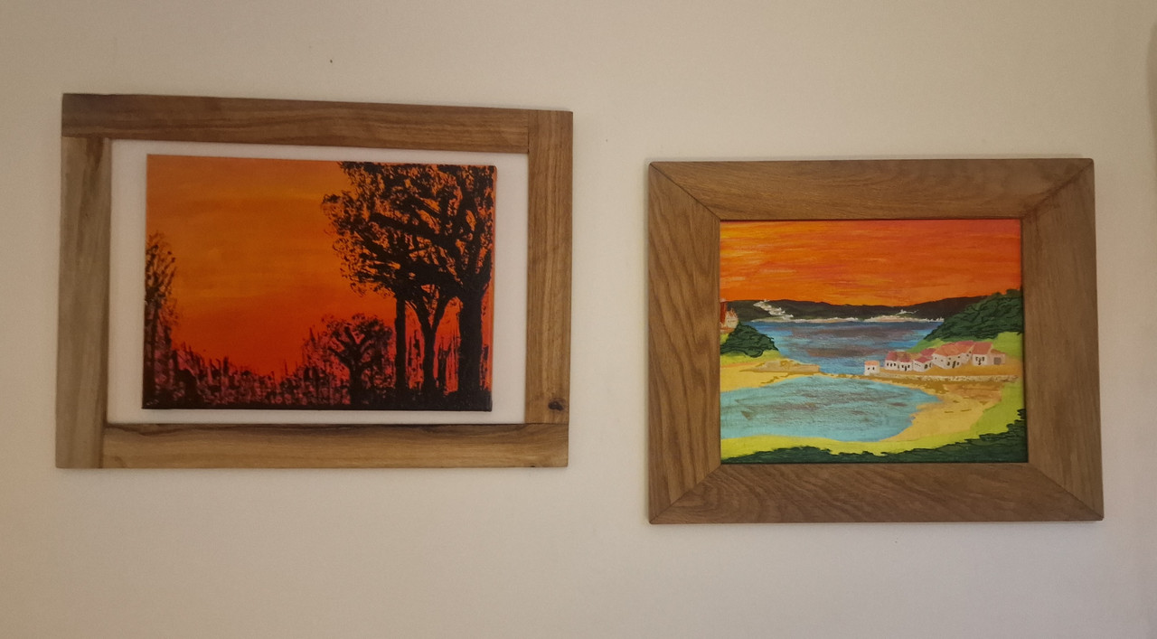

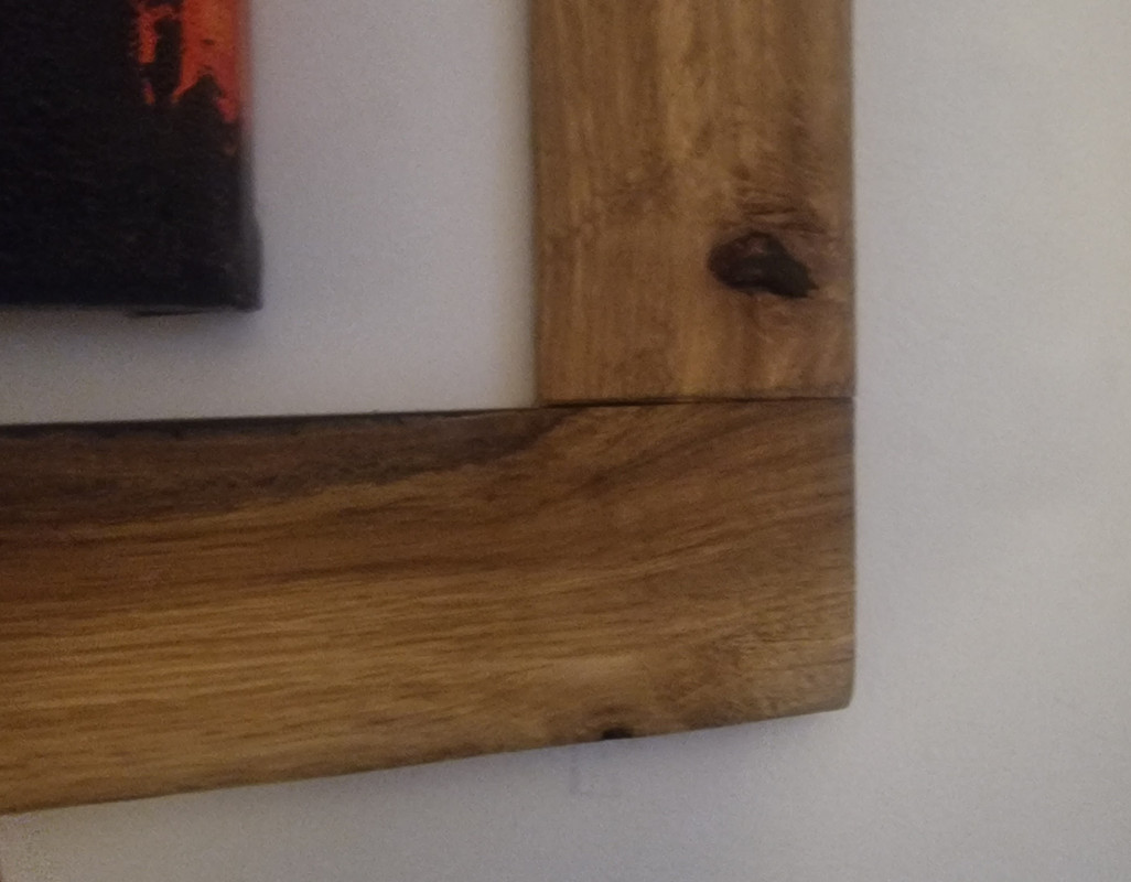

I have a few picture frames I have made from scrap wood but the dark wood is sucking the colour and life out of the paintings. Any clever ideas for lightening them?
I was just going to paint them with white emulsion and then sand back to show some grain but i am sure the great & the good of STW have better suggestions.
The left one is oak I think
No idea about the other wood used

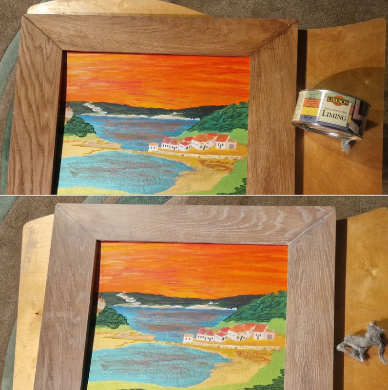

Here is a quick update after finally getting around to liming one of the frames.
I will see what 'she' thinks about it before doing and more but it is quick. easy and I don't think it looks that bad. I might play around with more layers to see what happens but pleased with this first attempt
