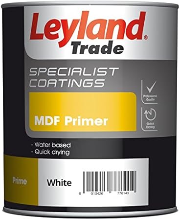

I've used this stuff quite a bit when making mdf wardrobes etc.
It's quite good. It's kind of a bit thicker so seals the edges well. Still want two coats though.
I also used to give the edges only a few coats of water based varnish, flat it back. Comes up beautifully. Then prime and paint.

I make and paint quite a lot of MDF furniture. The Leyland MDF primer is decent, but I get just as good results using their bog standard acrylic primer undercoat which also happens to be less expensive. I tend to sand faces and edges to 240 grit, get a coat of primer on to 'raise the grain' (I'm aware MDF doesn't have a grain in the traditional sense but you know what I mean), then sand again at 240 or 320 before using Leyland hard-wearing acrylic eggshell. Two coats of this using a Rota double concave foam roller gives a good finish, which I've never had a complaint about. I do use moisture resistant MDF, but the same principles apply to normal MDF you just may need to repeat the sanding/coating process more times.
