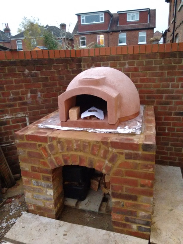

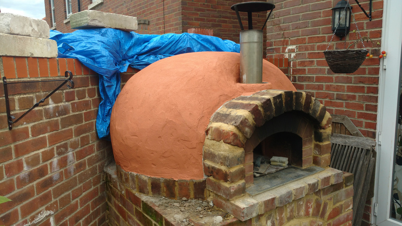

Our mezzo at previous house. Rustic brick work all my own.
IMG-20151101-165555596
IMG-20170820-141438653
Posted : 31/01/2021 7:37 pm

The nice thing with using a kit like above is that as soon as the base is done and the oven on it you can cook. Yes doesn't hold heat as well as then insulated but still easy to get to pizza temp. We bought the full build kit that comes with the floor and some insulation. You can also see the prefab arch inside the out brick arch I added. The oven above was our second heavy oven. The first was a hand built clay oven with firebrick floor.
The prefab got up to great much quicker and once insulated kept the great much longer. Insulation wise I added a roll of house insulation on top of the lion insulation that came with the kit. This was partially to get a better shape before the chicken wire and render and partially for longer heat retention.
Assembly of the two floor parts and the dome is simple enough. I used play sand on or under the insulation to get the join perfectly level. Moving and placing the dome needs 4+ people as it's really heavy. The floor pieces by comparison I could move my self.
As for leaving uncovered we did in nicer weather but if it was nasty or the oven was not being used for a while it had tarps over it. We used to take the chimney it to do this as it stays hot enough long enough to destroy tarps. Normally we would let it cool fully before covering (1+ day). The main area of weakness is the chimney entry point. I never got around to it but was intending to fit an extra cowl to the chimney to protect the joint with the dome.
The 76cm size is just enough for bigger parties. It was smaller than the clay oven I built (80cm I think) which made internal space a little tighter but cooking 2 pizzas at once is not an issue. I think the next size up at 90cm is a little big for family use and takes longer to heat.
