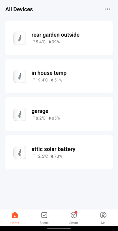

Well my rear gardens currently 5.4deg and my garage is 8.2dwg
Retained heat from when it was sunny 2 days ago
