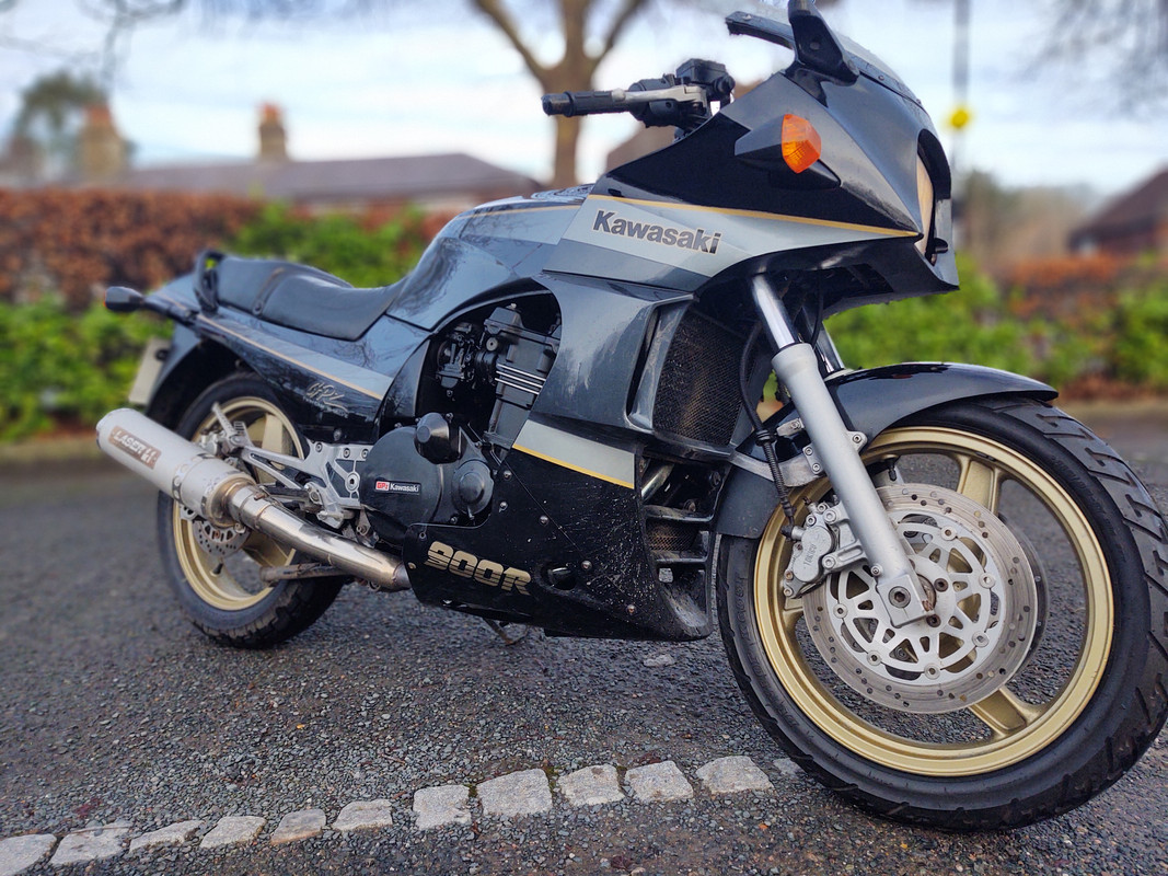

Hi, have an old GPZ900R, old style carbs.
1
Have done a bit of work and generally all good. But, a full tank of petrol should give me 140-150miles, before turning the fuel tap to reserve. However, it's going to reserve on 110 miles, normal riding.
It's idling beautifully, pulling v smoothly through the range, no lumpiness of grumbling. No signs of smoke, but can sometimes smell slightly petrol-y when stopped and switched off after a run.
The fuel gauge sender is next on my list to fix. The tank has been cleaned and resealed from rust.
Any clues as to what I should look at?

The float chamber valves may have dirt stuck in the carbs causing over fuelling when running and overflow when stopped?

Check the fuel tap itself? It went on my kwaker gt 550 and would slightly leak.
Very nice bike!

I think the fuel tap on these was vacuum operated, i.e. should shut when the engine's off. If that's knackered and allowing fuel into a (leaky) carb...

+1 for leaky float needle valves, especially if you have had the carbs apart. You don't see a puddle because the vacuum fuel tap shuts the petrol off when stopped.
You may see a few drops of petrol from the carb overflow tubes if you leave it idling for a while.
If there's been rust in the tank, some will probably have found its way down to the carbs where the big bits tend to get stuck in the float valve seats, preventing the valve seating properly. If you take the float valves out, you'll probably find some rust flakes behind them if this is the case.
