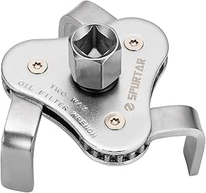

You might need a new sump plug, chain tool to remove the filter and a suitable container for the old oil.

Investigate what tool you need for the filter, traditional canisters a strap wrench, but a few these days are just a filter element in a reusable housing, i.e. my Toyota needs a big cup shape tool to take the housing off.

Make sure you can reach and grip the oil filter first. I have probably 5 oil filter removers I have had to use over the years with different cars and don't think I have ever had the 'right one' 🙁

thats 150 quid each, or 100 quid for both diy. I also need to replace the oxygen sensors, so thought that would could be done at same time
Oil changes are easy enough.
There's various tools to help get filters off*, personally I much prefer this type to the chain/strap type but it comes down to accessibility, I've got all three (a chain wrench, a strap/lever and this thing) and each car I've had has been different. Also depends if you're doing it from above or below, some cars it's possible from both sides but needs a different tool.
O2 sensors are a bloody nightmare (assuming you mean the exhaust lambda sensor). Depends where it's located, mines on top of the engine at the back under the bulkhead so can't get an impact driver over it. So it's going to need a breaker bar and a prayer it doesn't rip the thread out with it.
*assuming a canister filter, not a cartridge.

I’ve got all three (a chain wrench, a strap/lever and this thing)
This sums up the entire thing for me. You either want to do this sort of work, gather all the tools together and do it regularly over years, along with other routine servicing items, and it becomes, in effect, just another household chore that you just get done like sweeping up the leaves, or clearing out the gutters. Or you stump up for a garage to do it for you. It's the folks that fall in between those two options who think "How hard can it be?" that generally come a cropper.
