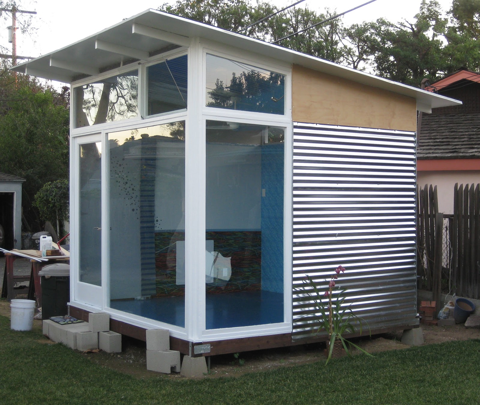

Metal cladding? Galvanised?

As you are having a membrane and extra wall, I would also consider galvanised wavy metal.
