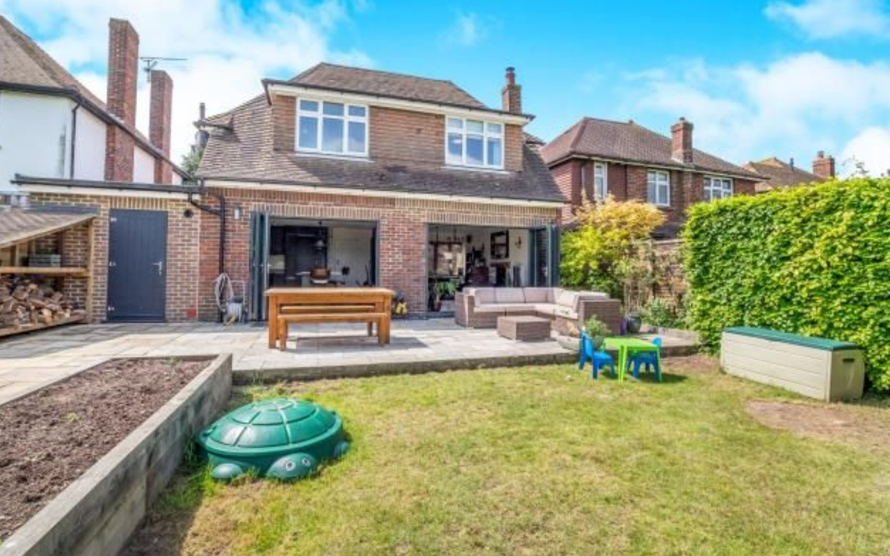

We have 2 panel bi-folds over 1.6m opening. Our situation is slightly different though a we have 2 sets next to search other separated by a 30cm pier - one set opens left and the other opens right so we end up with a large opening.
We like the arrangement as 2 sets of french doors wouldn't have worked.

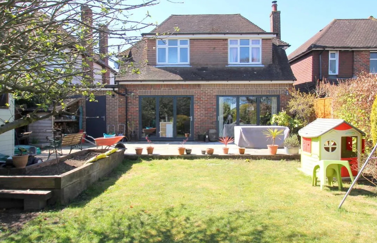

I thought the 'standard size' is slightly larger than 1750mm - these guys do standard sizes and it's 1790mm. We have two sets and they have been very good - we regularly have just the one door open as a 'traffic door' when walking in and out of the garden during cooler months and it's absolutely fine (it certainly doesn't feel too narrow). They also supply door catch kits so the single door can be help open.
I have been really happy with ours - and I thought they were very good value for money (and very well made).

Thanks all for the replies. I hadn't really thought about the reduction in glass, more the practicalities of having the traffic door and being able to fold it away neatly. I've added a pic for context, I'm in a similar position to sharkbait as I intend to add another room to the behind the garage and have the same doors there (one day). As such the bifolds opening out and meeting in the middle would be the tidiest solution.

Think for the smaller aperture either stick with sliding patio doors or French doors. On our extension we had larger apertures put in and two sets of BiFold doors similar configuration to ta11Pau1 photo and it works great with Bi-folds and just wouldn't have worked with patio doors or French windows...though the idea of fully opening up the bifolds on a sunny day is romantic, the reality is we have only ever done it a few times. On a hot day you really want the inside of the house to be as cool as possible so opening up the aperture and letting in all the hot air from outside is not what you want. Also if you do that then you spend the next week trying to deal with all the flies and insects that come into the house. So we only ever find we use one side and the other side hardly gets used. But certainly good for letting in light.
For a standard sized aperture I'd probably just stick with conventional patio doors or French windows.
