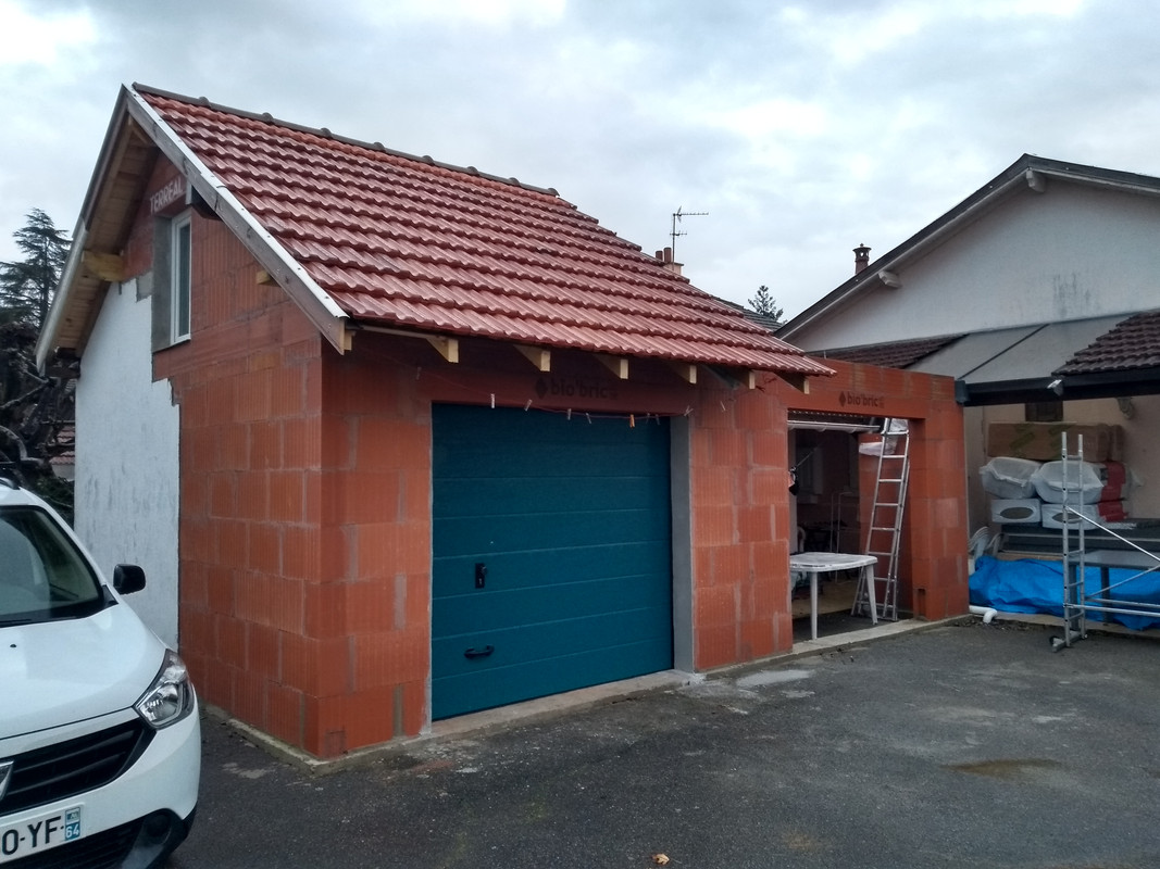

Most garage doors in these parts are four panel things. The panels are 45/50mm thick steel sections filled with polyurethane foam. There are lip seals between the panels, on the sides, at the top and bottom. The internal frame/runners butts up to 100mm insulation nicely to cut the thermal bridge around the frame.
They cost about 800e but I picked this one up second-hand for 150e from someone converting their garage to a living room.
