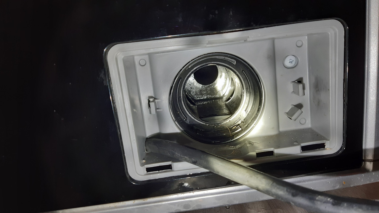

Posts: 2295
LG Filter check-clean
Here's mine:
Clean as a whistle.
I'm 99% sure it's the pump. If I put my hand on the filter with the machine running I can feel the filter cover vibrating at the same frequency as the rattling noise.
