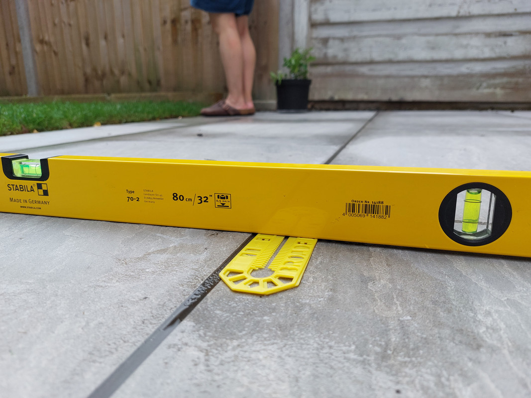

Got a new patio last week.  It rained yesterday.  And some minor pools of water became visible as it was drying out:
[url= https://i.postimg.cc/SjtKzsrj/20230814-105105.jp g" target="_blank">https://i.postimg.cc/SjtKzsrj/20230814-105105.jp g"/> [/img][/url]
[url= https://i.postimg.cc/0MVyn21W/20230814-105147.jp g" target="_blank">https://i.postimg.cc/0MVyn21W/20230814-105147.jp g"/> [/img][/url]
They're small, so not the easiest to photo well.  And I couldn't measure either but I'd estimate max 2mm deep.
Overall there's a good drop to the patio: I measured 38mm in the first 1.8m away from the house - so more than a 2% gradient.  But a few of the last slabs are fractionally above the one before, where this water is getting caught.  They're porcelain slabs, and I expect something porous would absorb the volumes we're talking about pretty quickly.
I can't say it bothers me too much.  But if I'm supposed to be expecting it to be perfect... then I might have to consider calling them back.

It's raining again so this has caught my attention once more. I measure a 2mm step between the 2nd and 3rd last slabs:

They're on a pretty smooth gradient overall, apart from these minor steps in the wrong direction. And the photo is looking away from the house, so they aren't deliberate to prevent any flow-back.

I would want to lay a straight edge over three rows of slabs across the water from the lawn towards the house. If the slope is even from the first row to the third row other than the pool it would appear the water is pooling where the edge of that slab is a couple of mm low and could be corrected by raising that edge of the slab.
Of course it would have been better if this was  noticed prior to grouting.

here's the problem with large format tiles in 50% brick layout. Particularly prevalent with cheap chinese tile means Warpage or cupping along the longest length means that you can't avoid lippage in the center.  You could split it and have imperfections at the and joints as well as the center of the longest length but the setter has likely just focused on lippage where they butt on the shortest length. 33% overlap is often a solution

As Dirk above, I was going to ask are the slabs themselves flat? If they have any kind of bow, then will be physically impossible to have them without small hollows when laid in a staggered pattern.
I've had the same with smaller wall tiles - luckily it looked ok as a "feature", but it explained why the tiles were seconds / cheap.

not just the cheap porcilain, i fit a lot of quite expensive italian/spanish stuff and that can have quite big bows in it, can even be flat for 3/4 of it's length then dive of a mm or 2.
always try and avoid doing 50/50 if possible and sometimes it even states on the box not to.

Just finished laying a porcelain patio last week, all the slabs bowed at the end (900x600mm) although the slabs appeared flat they were anything but , you have to find a happy medium so I level from the highest point.
Obviously I mention this to the customer and show them....but the main objective is to push the water away from the house with the least fall ( bubble off level touching the line)
