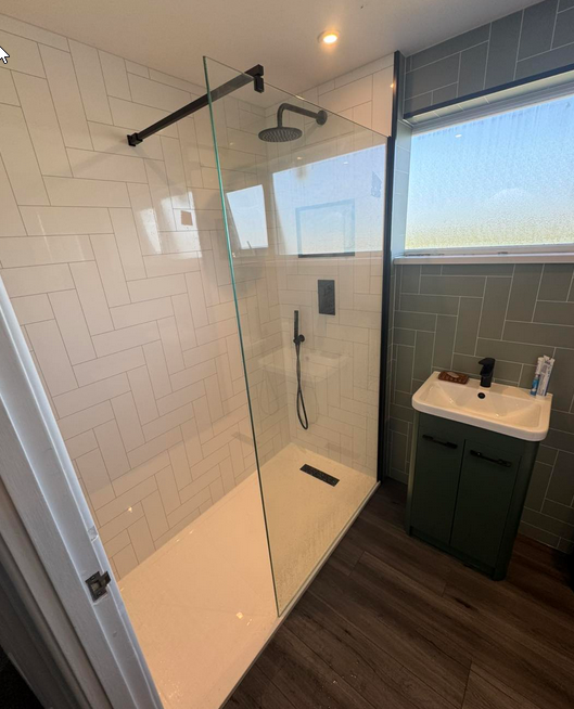

Johndoh, i can't unser those two identical tiles next to each other on the right now. Thanks.
Posted : 28/04/2025 12:36 pm
Posted by: joshvegas
Good spot 🙂
Posted : 28/04/2025 3:06 pm
Posts: 19694
It's just where they're consecutive slices from the same bit of marble, innit 😉

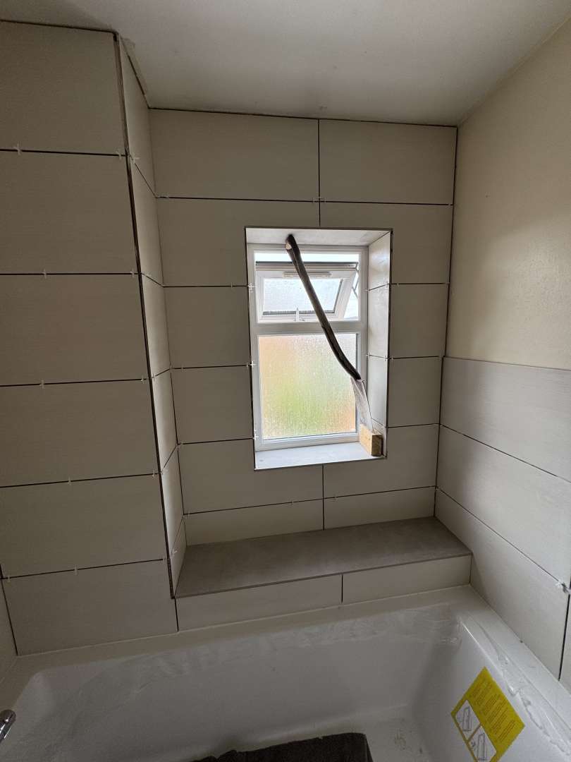

I'm finally ready to grout, is there any prep I need to do first?
Posted : 02/05/2025 8:34 am
Posts: 5484
Our receently Travelodged bathroom -
Posted : 02/05/2025 9:55 am

Posts: 5222
The bath is siliconed already.
I’ve just to grout between the tiles.
Posted : 02/05/2025 11:55 am
Posts: 18073
Looks good, I can't think of anything beyond choosing the colour of the grout. 🙂
