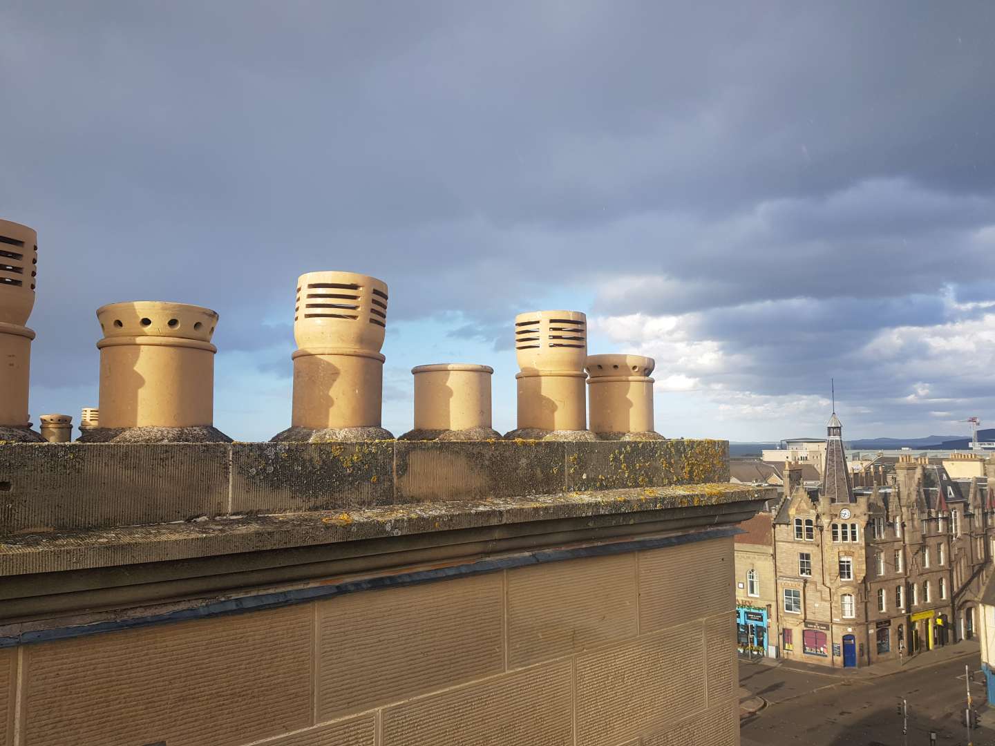

Help me out here.  How does a chimney cap not the whole pot fly off and break a window?   I came back from my trip to find the vent cap off a chimney pot thru one of my windows.
The cap weighs a couple of kilos and sits down in the pot.   Its in a fairly innaccessible place.   Im in the attic of a 4 story tenament.
I just cannot see how this can happen.   Surely the wind or venturi effect would not be enough
If someone did it surely they woild have picked a more accessible one 20250525_191442.jpg20250525_190742.jpg

Not a sweep as the chimneys are not in use hence the caps - I am fairly sure on this

That's only half the cap..... I've had the top disk out of that cap come out the neighbours chimney and hit my dormer......
You say they ain't in use ... But is it possible  the owners tried to re commission them as is popular trend in gentrified areas.

trailrat - its the whole cap.
Its all offices below me and all the fireplaces are gone.
I have asked the owner of the rest of the building if anyone has been doing work on it.  Its the only real explanation
I can assure you that they weigh considerably more (well, the red ones do anyway 🙂 ) That looks like the larger size as well
Human intervention of some sort, mine are bedded on mastic to keep a bit more of the rain out

these just sit loose in the pots.
Its a mystery.  I might go and ask in the offices that could have the chimney in them but I am fairly sure the fireplaces have gone so they would have no access to the flues
Its really difficult to reach from the roof.  I don't think I can put it back safely

because the stack is on the side of the building on a sloping roof I would have to walk along the top of the stack from the flat part of the roof.   The ones at the end are easy to reach.  there is also a very territorial herring gull nesting on the roof

Were you out of the country for storm Eowyn? Roof damage was widespread, if the pot it was sat in is loose then it could have tipped enough for the cap to fall out.

All the ones that I’ve come across have been secured to the pot with mortar, or in the case of “‘half a job”, silicone. I would think that it’s possible that it’s blown off. Or a cat burglar?

the chinmey pot is secure.   Its the cap that has come off as in the pictures
Yes - just been down to the office below - they said they spotted the damage from the street after the storm and came up to the flat ( they have keys) to check it was all secure so it looks like that must have been it.  I didn't really know about the storm.
If its a long flue I guess the wind much have created enough draft to blow the cap off.  Still weird tho as the cap would have to lift up 6 inches to come out of the pot

I've got a couple in my yard for a job. I just popped out and weighed one. It's next size up from yours I think, and weighs an impressive 9 kg. It's highly unlikely it blew off out of the can, more likely a sweep or it was taken out for an inspection and forgot to put back in. Then possibly wind moved it and crash
The wind load on some chimney stacks is enormous, I see plenty of them in a parlous state but never seen one blown over. Yet.
Posted : 26/05/2025 1:38 pm
I checked with the building main owner - no one has been on the roof to do any work and the offices below the fireplaces are all blocked off.  I can only imagine a gust got in to the building somehow and vented thru that flue???
I'm not convinced, but then I know nothing of Edinburgh's weather. We have four of the that size and they're 6kg each (according to Travis-Perkins)
Two are in octagonal chimney pots and are on 3mm aluminium plates so that the the pot corners are covered to keep the rain out. all four now sit on a mastic bed; if any were going to lift then the two on adaptor plates would have done pre-mastic.
That doesn't help you now, but a pro should check all of them, maybe you can split it with the other occupants??
