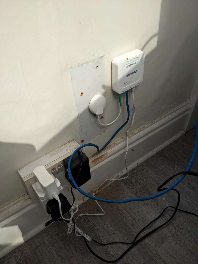

Is fibre to the property available to you?
My street recently got done.. fed from telegraph pole.
This made the BT master socket totally redundant, openreach come round and drill a hole in your wall and fit a new fibre box thingy (MODEM?) which you plug your router into.
I used an existing hole in the wall as it was just better for me, but I think standard practice is they drill a new hole...as the open reach guy wanted to do that initially until I persuaded him otherwise...so you could save yourself a job if you are thinking of going fiber any time soon.
