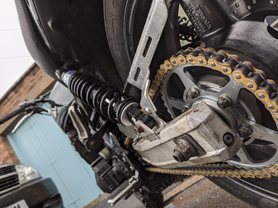

I've recently started to get this horrible clunk on my gsx750.
It happens mostly seemingly when I've slowed down for a junction or something and then I'm accelerating up again.
Seems to disappear at higher revs where the engine runs smoothly, but building up to speed I can hear a clunk and even feel it a bit through the pegs.
I've checked everything I can think of and can check easily.
Chain tension, chain movement (removed it and checked all the links move ok), checked sprocket bolt is tight, rear sprocket is tight, chain sliders on swingarm are all running good, sprockets don't seem worn.
Anyone got any ideas what to check next?
Here's a short clip of it up on my paddock stand running in fourth.
You can hear that occasional clunk and the chain looks to be jumping about a lot, though obviously it may run differently sat on it and suspension compressed.

That's normal when running on the paddock stand, there's no load on the rear wheel so the inertia of the wheel causes the chain to flap. It won't happen on the road as there's load going through the wheel and load on the suspension. Also, how often will you be in 4th gear at idle?
Now, the 'clunk' at low revs - how low revs are we talking?  Could just be the engine being lumpy down low and causing the chain to slap when at low revs. If you can feel it through the pegs, I'm gonna say you're in to high a gear and labouring the engine. These things red line at 10k+ rpm, they're not meant to be ridden at 1500.
As yours is an IL4 it should only happen at just above idle, get to 2k rpm and it should smooth out. A v-twin on the other hand will be lumby under 3-4k.

Yeah I expected a little on the stand but it does happen on the road.
It's lower revs and really, when I back off on the revs. I can sometimes feel it through the pegs even though I might be going say 50mph.
It's always been really smooth. This is a new thing last few rides.

How old is the chain? Is it a lot slacker at some points when you turn the wheel slowly. If it's time for a new chain might be worth changing the sprockets as well.
Posted : 14/06/2020 10:51 pm
My only experience of that was on a training center Honda 500, it was almost unrideably shagged. Close the throttle and there was enough of a jolt to throw you forward like the back wheel locked up.
If the chain and sprockets absolutely, definitely,aren't worn then have you checked for play in the gearbox outpush shaft? Or does it have a cush drive?

Sounds like you've lost a chain roller.
Stick the bike on the stand and rotate the wheel look at each link in turn. If one of the rollers is missing you'll just have a skinny pin. That doesn't engage with the teeth, rides on top and clunks in place.
You wouldn't think it would be possible to lose a roller, but I've seen it twice.

As been mentioned,check that the gearbox sprocket it tight on the splines.My wifes Hornet developed a similar problem and it was slightly worn splines that accelerated wear on the sprocket.A genuine honda sprocket along with some stud lock helped mask the issue.

cush drive rubbers is a big 'clunk' when the clutch is dropped and similar big clunk when rolling off or on throttle.
The frequency isn't correct for chain issues - that would be a constant rythmic 'chink...chink...chink...chink...chink' type frequency.
Your issue looks very high frequency/low load so something like a gearbox bearing having shat it's cage.
Do a bit of roll on roll off throttle action to figure if it's secondary drive related ie output shaft sprocket.

Been running it up on the Jack with the sprocket cover removed. Still clunks and jumps about like a mofo.
I drove into a bike shop and they had a quick go up the road and basically couldn't think what it might be either. I suggested I changed the chain to rule that out, but the dude was pretty sure that the chain and sprockets looked fine and well adjusted.
Here's a vid of it running without the sprocket cover.
You can see it clunk and skip a bit, but the sprocket itself seems dead consistent and true.
Like I say, it only happens when accelerating. As soon as I pull the clutch or shut the throttle the noise goes.
I've got it booked into the bike shop on Monday for them to take the clutch out and have a bit of a deeper delve.

Just to update anyone interested, just got the bike back from the bike shop.
They removed the clutch basket and inspected everything. Clutch plates all good but they did find that there was slack in the engagement/pick up of the clutch and play in the basket or main shaft.
So, it's not been fully diagnosed as such but it's looking likely that it's something going on internally.
Not sure what to do really..obviously I don't want to do any damage, but with it being summer, I also don't want to or have the time to strip it right down to the gearbox when I'd rather be riding.
The bloke said it's likely a days labour for them plus any parts needed to strip and rebuild it, so I'm more that likely looking at about 6-800 quid I guess.
Not sure what to do really. Bike cost me £1300 and I love the bike, and have already done some custom stuff on it which is what I'm aiming to do more of, but obviously that's a lot of money on a year 2k bike.

I would have thought new chain and sprox would sort that out especially if it's the original, would of thought the clutch was an issue, that would cause either dragging or slipping, if the plates are OK and the basket isn't notched I wouldn't worry about that side of things.
If it's not the C&S it could be the splines on the output shaft (were the front sprocket's attached) that's worn - caused by the chain being to tight ?

Yeah but the shop mechanic has had the clutch all out. Says the bearing is fine, the clutch is all fine, and the chain and sprockets are all fine and well adjusted.
I think he meant there is a slight rotational delay in pick up to the final drive, and that there was slight lateral play in the clutch basket. The clutch itself is fine, but I guess the shaft it's running on has a little play.
I don't know. I mean they didn't really overwhelm me with details of what they found, but suggested they think it's an internal issue and so anything else they do would be part of a gearbox rebuild. 💰

I was going to call the bike shop this week and arrange for them to rebuild the gearbox. Ready to tackle a massive bill of probably 800 odd or so.
Anyway, I thought sod it, I'm just going to stick a new chain and sprockets on there just to rule it out 100% for £96
Goldie Lookin' Chain
Well, I've only had a quick spin around the block as it's wazzing down and I've got shorts on but, it would appear to not be making the noise!!!
Got to take it for a proper ride when it's dry but initial impressions look promising.
The bike shop said my chain and sprockets were fine, and they looked pretty serviceable when I removed them to be fair, but there you go. Maybe I'm sorted! 😊
*Thread returns next week when noise returns...
