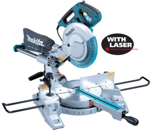

very good and portable. find one on ebay for about £200[url= ] makita[/url]

[url= http://www.dm-tools.co.uk/product.php/sn/MAKLS1018LAS ] my choice.[/url]

I have the big brother still going strong 10 years on.
