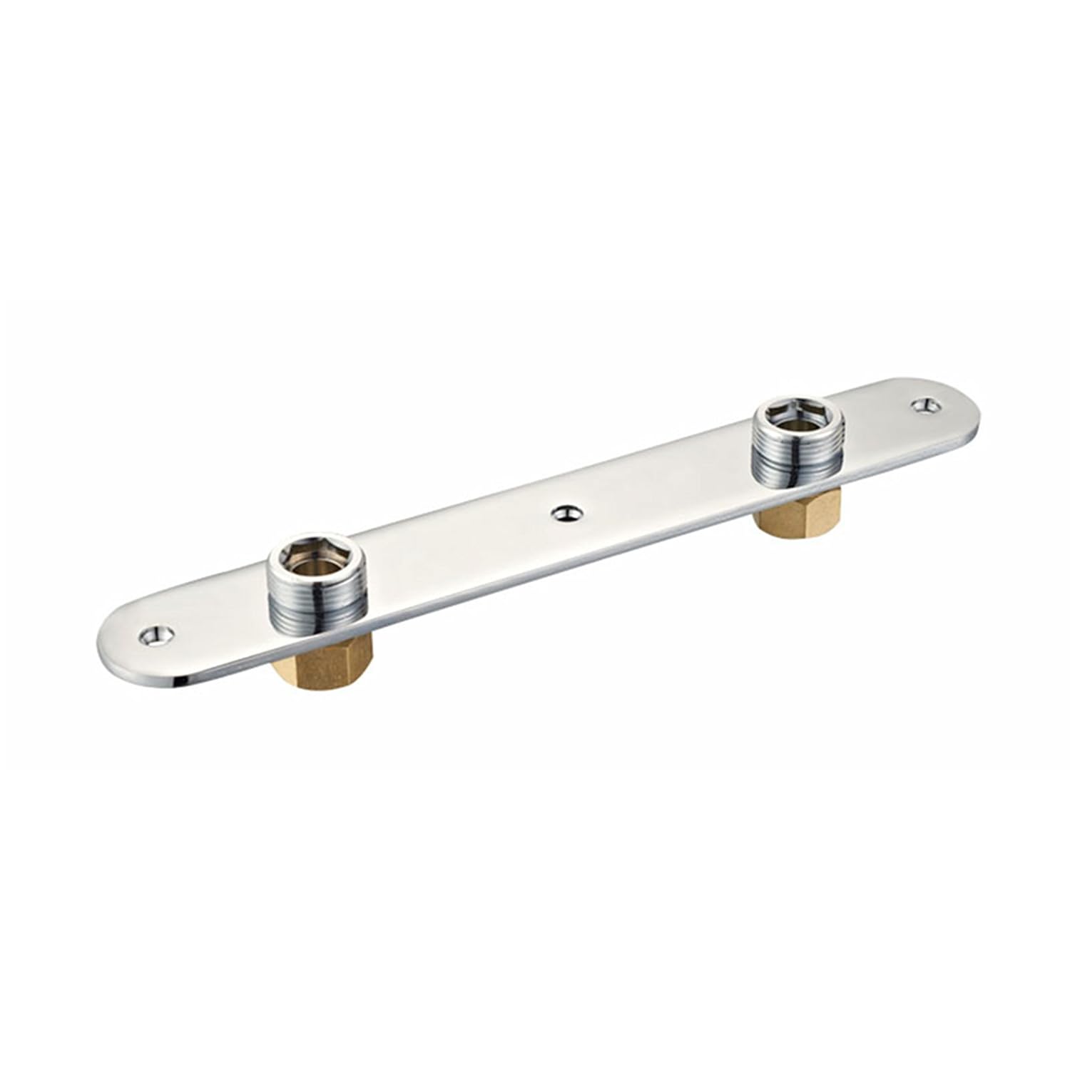

Posts: 1899
I fitted a bar shower specifically because they are the easiest to replace / work on when they break. No faffing with tiling.
The bathstore bar inevitably only lasted just beyond the warranty period, so it got replaced with a Mira similar to the above.
I used a mount like this to rigidly mount it:
Posted : 06/01/2017 10:20 am
