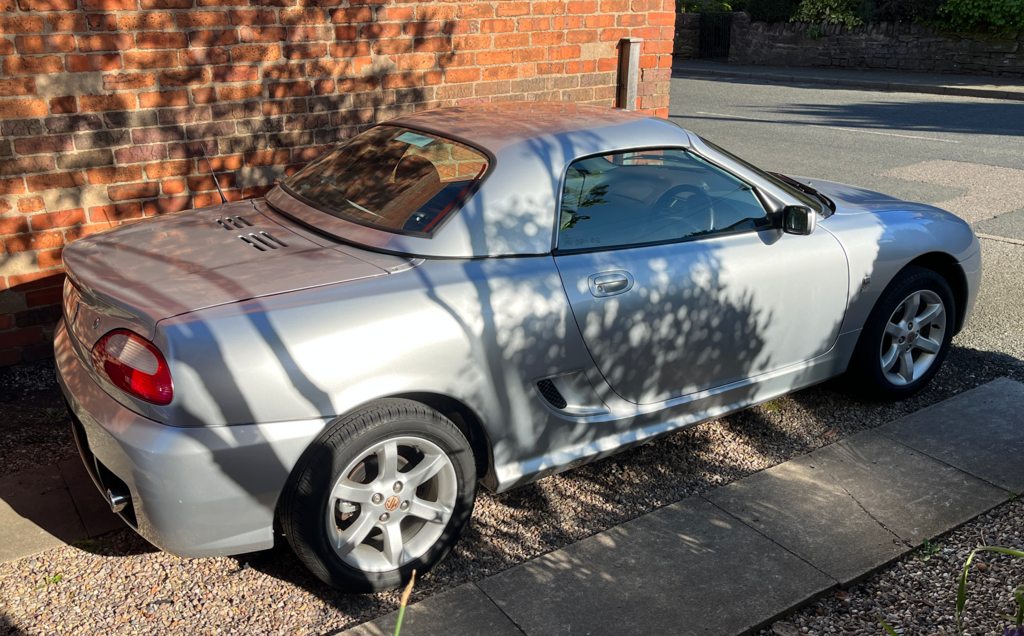

The TF is on the driveway (yesterday) - let the adventure begin!...
...feels tiny, even compared to my Civic! 🙂

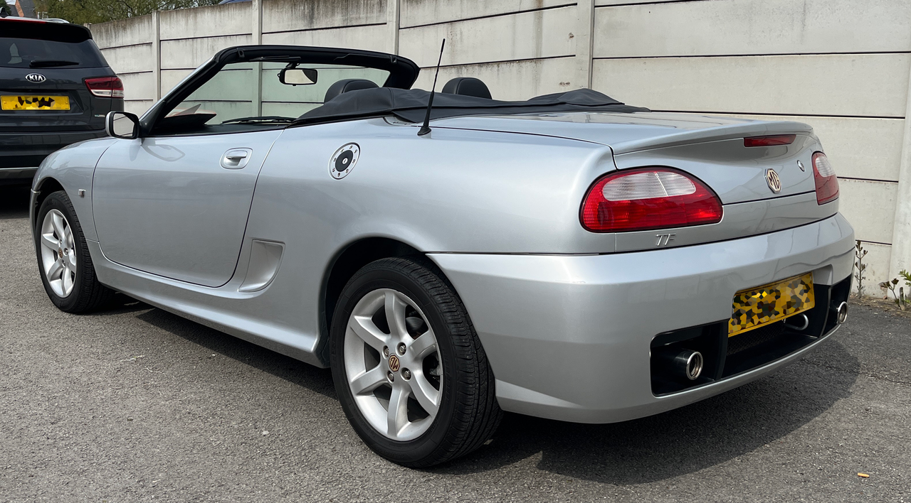

4 months in and I'm loving it - it's pretty much my daily driver now. It squeaks, it rattles, heater is a bit dodgy, drivers window leaks if you don't quite have the hood in the right position, you feel like you are doing a 100mph at 50mph. This mornings misty commute... 🙂
Posted : 06/09/2023 3:02 pm

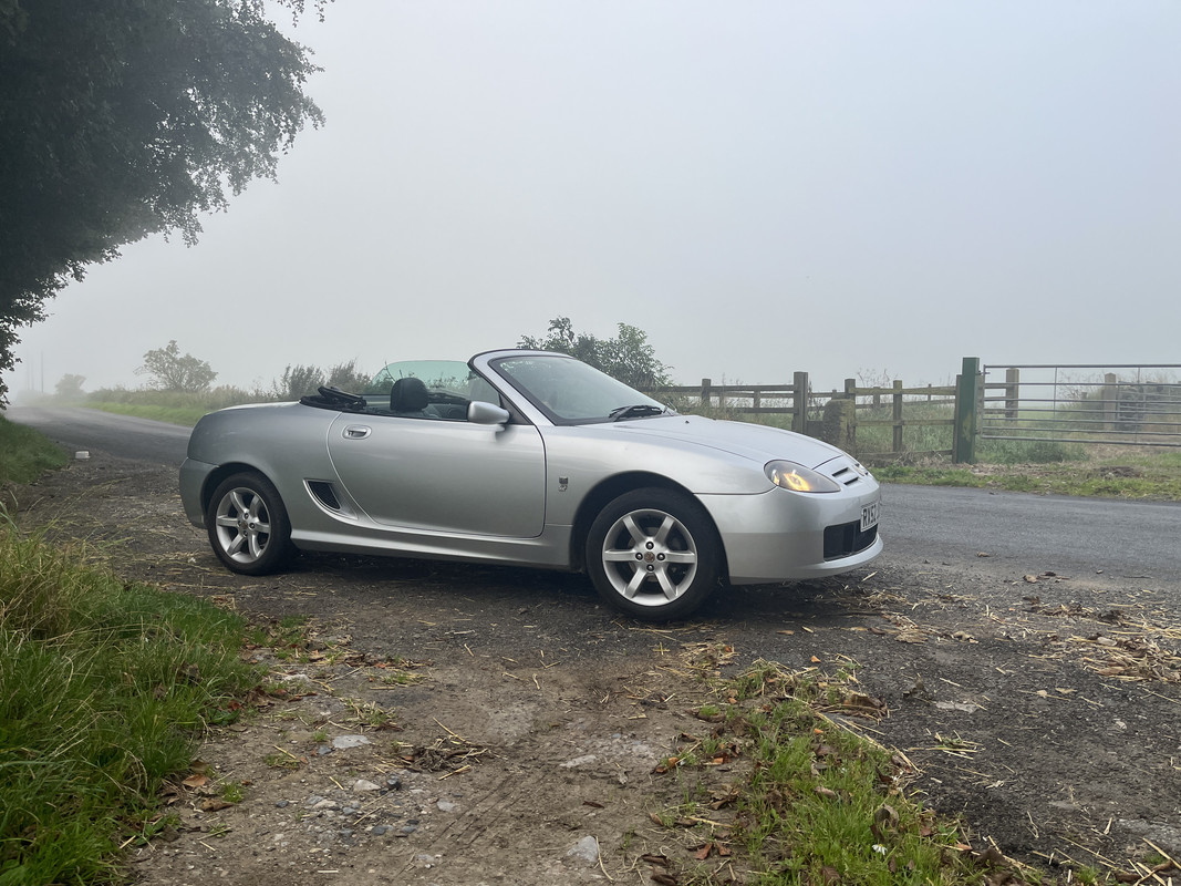

My daughter nicked the MG last night and took this photo - I rather like this photo with it sat there all alone! 🙂
Posted : 05/09/2025 8:45 am
