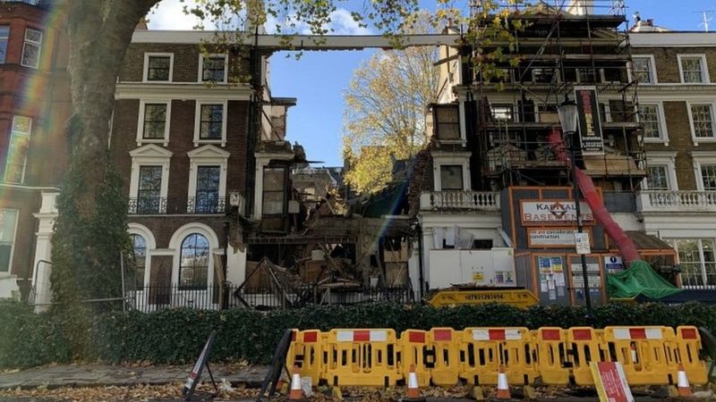

Posts: 2948
Yeah, dig down. What could possibly go wrong...
House collapse
Posted : 30/11/2020 7:14 pm
Posts: 3384
What's that from?
Posted : 30/11/2020 7:48 pm
Was a house in that London (I believe Duffy, the Welsh singer used to own it) that decided to do the whole cellar conversion thing, it went slightly awry....
Posted : 30/11/2020 7:53 pm
Posts: 2948
nobeer, I don't think this one was hers. This was quite recent (3rd nov)
https://www.bbc.co.uk/news/uk-england-london-54794723
Posted : 30/11/2020 7:55 pm
