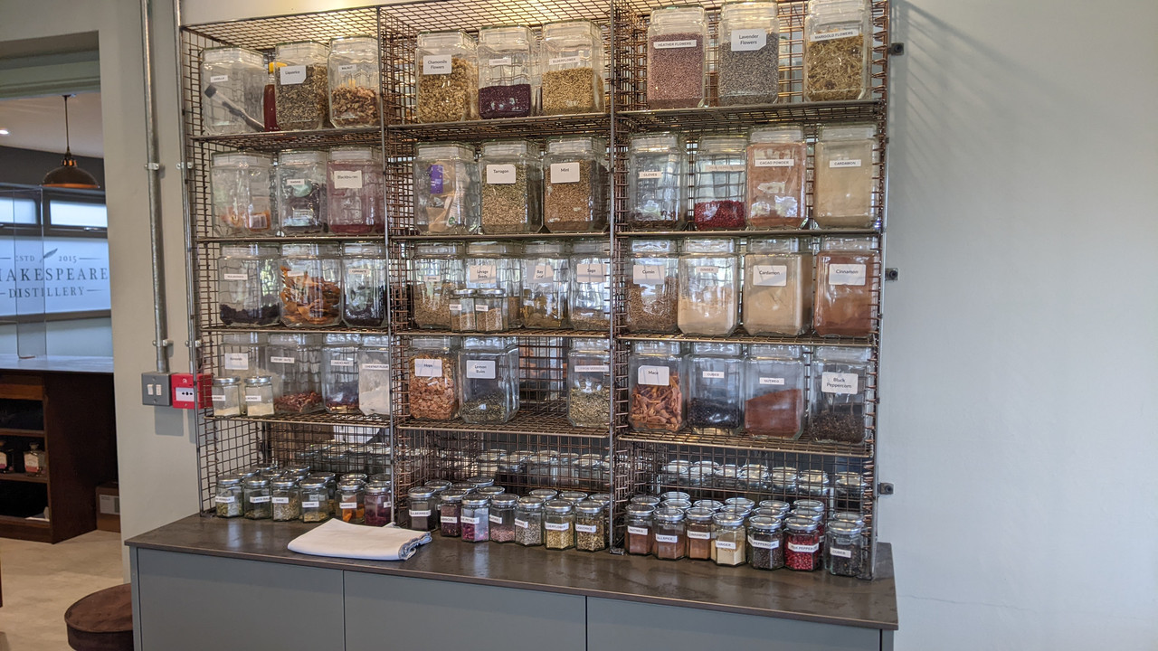

I have a potential project coming up where I need to build some industrial-style metal shelving that's similar to some existing shelving for an interior designer.
I'm just researching materials at the moment and wondered if a particular 'profile' that's on the shelving pictured is something common or whether they may have had it manufactured as a one off?
I'll send the pictures to some suppliers of course but I thought that someone on STW is bound to know.

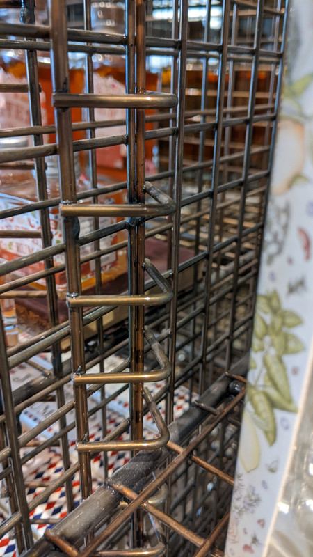

It's a strip of parallel rods with perpendicular L-shaped pieces welded in series that is used to make the shelves adjustable in height.
Any ideas?

that looks like a faff. it kinda looks like something a bakery might use but i drew a blank.
however i think its formed from a bent rectangular mesh rather than built from bits

Not specifically, but you can get rectangular welded mesh for the support sections and matching square mesh for the shelves (mesh example). The same company can cut and fold the flat sheet, finish afterwards to taste
Ah yes, makes sense.
Cheers. I'll send them some images and see if it's something they'll do.

That doesn't look like a commercial product to me. While the welding is better than I could do, there are blobs and blackened areas; if it was a production item they would be ground off and would it would be uncoated stainless or coated after welding.

I think the blackened areas are where they've attached elements together. The actual bent sections look fairly clean and consistent I thought.
The company that commissioned it originally wanted that sort of raw look I think so weren't too bothered about blackened welds and such like.
(Ampwire were who actually made it I think)
It's lacquered over the top.
To be honest, I'm not sure about quoting for the job as it's fairly far from what I am used to, but then again, I love getting my welding head on and it might be fun.

its simple to make. i guess you can fold the mesh with a brake press, and use a bender for the tube corners, and a guillotine to cut the mesh to size, if you have access to those machines. Or improvise.
I dont think you can buy it off the shelf, but take a look on ebay, someone may be selling it, and if they are they will be happy probably be happy to adjust dimensions for you

I'd probably start by measuring the length of the 2 legs of the sticky oot bit of those shelf supports, the diameter of the rod they're made of and the spacing between them and have a word with a steel stockholder to see if it corresponds to an off the shelf mesh that could be cut and folded.
If you had to make those bits from scratch from steel rod with basic tools it'd get very, very tedious very, VERY quickly...
The rest looks straightforward enough but if you're fitting it into a wonky shaped corner it probably isn't 😆
