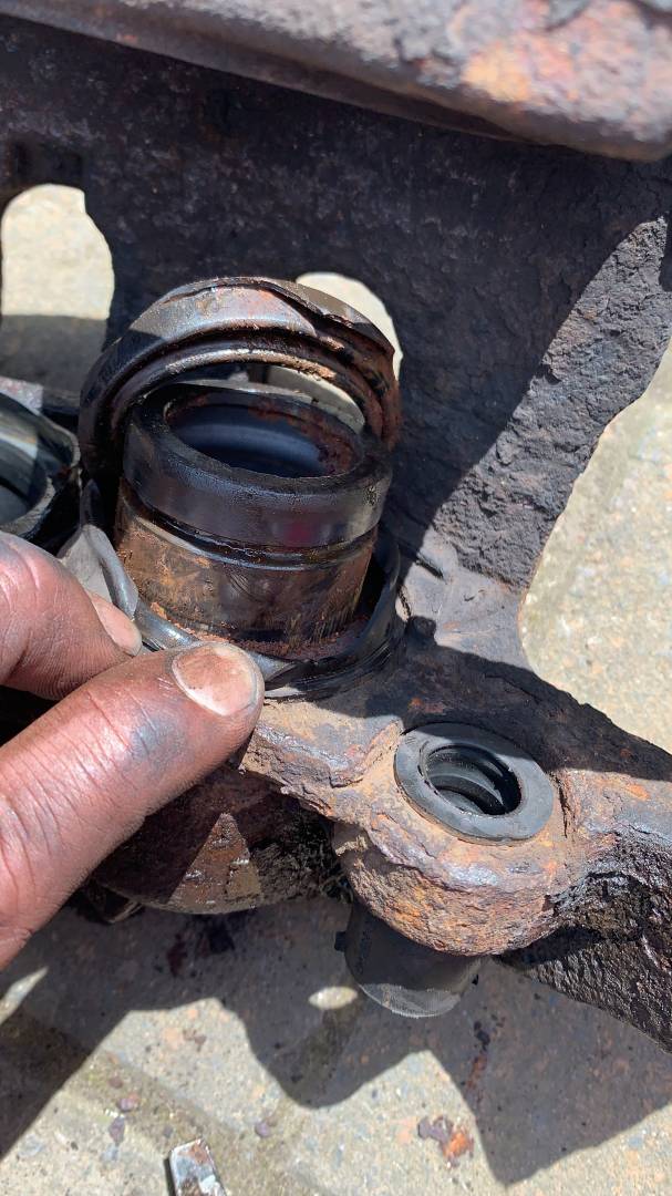

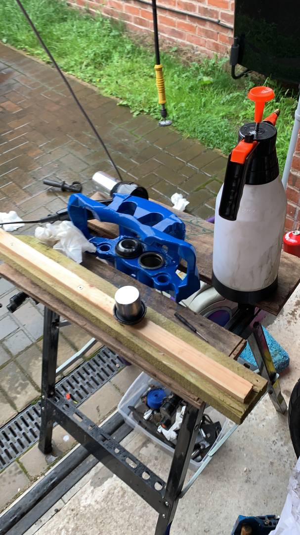

Posts: 4600
What callipers does it have up front? I had really bad occasional vibration on our last caravelle and it turned out to be one of its 4 front pistons was corroded and seizing. As a result just part of the pad continually dragged on the inboard side of the disc. It didn’t warp the disc but made it hot in places and grab the pad resulting in vibration. Rebuilt the calliper with new pistons, service kit and a blast /powder coat and all was well.
agree with molgrips and RNP in that “warping” like you might find on a motorbike or mountain bike is only a thing on unvented discs from 1980s cortina’s and cavs. What I think you get instead on big heavy ventilated discs is surface contamination from cooking them, stopping the car with the pad in one place and not letting them cool off with a run down. A seized piston will do exactly this
