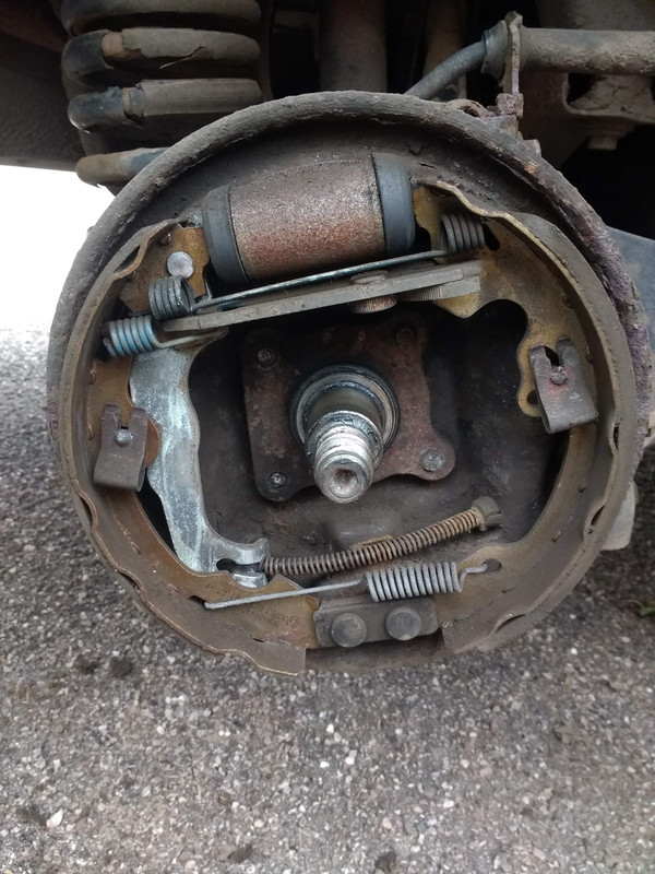

Posts: 497
Thanks Oldnick ..that was helpful but I think I now know the reason for the poor performance ..although ..actually ..thinking again maybe not ..let me explain .
I successfully removed the axle nut on one side which wasn't very tight and been fitted the wrong way round so some mechanic , sometime, had likely been negligent or not replaced the laminated nut. The drum came of easily and there was little corrosion to the adjusters etc BUT ...the lying , cheating mechanic had not replaced the shoes last year when I paid for that (and provided the shoes myself.) One side is very worn ..I'll add a photo shortly .
However ..despite that wear ..the brakes did pass on the main test so still wondering whether new shoes will make any difference.
I tried to look at the other side too but bizarrely , despite having what looks to be an identical nut , I was unable to remove it ...not because of the torque required but because the 3O mm socket, which fitted on the other side ,was too big for some reason and looks like I'll have to order a 29 mm tonight on Amazon prime .
Anyway ..all good stuff ..I'm learning a lot and getting somewhere . I need to learn more as , as I mentioned ,I have little money and so have to fix most things myself to save the pennies for rent and all the other things that are getting more and more expensive.Poor mental health and seemingly undiagnosed ADHD screwed my life up ..hence the lack of money , need to rent ( sold my house when depressed in 97 ) became an alcoholic etc ( have discussed on STW before ) etc but recently things are looking up . No pension, little money and renting at 57 makes for worry if I allow it but hey ho .. that's life.
Sorry ..gone totally of topic !

Posts: 497
Piccy
Posted : 23/10/2021 5:56 pm
Posts: 4170
Is it possible that the automatic adjusters have not been working but the handbrake cable has been tightened via its adjustment and pulled the shoes to one side so that one shoe has been dragging?
Edit - I should have refreshed the page before posting, and I've have seen your photo. The front shoe have a very thick lining on it. The back shoe looks worn at the bottom, but that might be the angle of the photo. If it was worn because of the action of the handbrake lever I would have thought it would be worn at the top, but not so much at the bottom, as that's a fixed pivot.
Posted : 23/10/2021 6:49 pm
 mc
Posts: 1190
I wasn't aware Ford used different thickness of shoes on the Focus, but that looks perfectly normal.
The leading shoe (front in this case) is the one that does the most work due to being self-energising and wears the fastest, so some manufacturer's saved money by making the trailing shoe thinner.
Handbrake cable does need slackened off more though, and the adjuster checked to make sure it's free and working.

On mine, teh old shoes came out looking much like that, not quite as exaggerated but pretty similar the new ones were equal thickness but they were Mintex probbaly rather than Ford OE so not sure if the genuine ones would be the same.
(also, 200000 miles! Mine got binned at 130000 and everything back there looked like it'd been carefully stored in the sea. Loved that old shitbox)

Posts: 497
Interesting Mr Spoon ..I see what you mean but I don't think it was that.
I've had both drums off now ..they came apart easily and quite amazing that there's no lip or obvious wear after 20OK . I've had it since 14K and know it's still on the original shoes.
Both brakes are much the same and fairly corrosion free ..just the trailing shoes on both are down to 2 to 3mm thickness wise and the leading sides have plenty of friction material left. Also the cables are fairly friction free.
The brakes may well pass now ..I've adjusted the handbrake nut and it holds well on steep inclines both ways but still does little to decelerate the car once moving. I'm not sure if that's normal ?
I'm probably going to fit some new pads anyhow .
It's been s useful thread for me and I've learnt a fair bit and am now keen to work more on my car . As I mentioned ..I've always left garages to fix my car and done all 2 wheelers myself.

Posts: 6312
Shoes a bit worn id say due to being over adjusted on the handbrake cable.
29mm sounds wrong. Normally they are 28 or 30mm. Check it's not a LH thread.
Back the cable off. Then using 2 big screwdrivers tweek the Shoes apart slowly you just want a couple of clicks if you go too far just ping the ratchet back. Bit trial and error.
You just want it to just slight hiss when you spin it.
Once foot brakes good then adjust the lever.
Posted : 24/10/2021 7:50 pm
Posts: 497
Thanks .Duncan ..The nuts were however closer to 29mm it seems .
I had to order the socket on Amazon prime and it arrived today and worked well. Funnily the 30mm socket worked on one nut but was bit of a loose fit . On the other side which appeared to be the same the 30mm was just too loose . 29mm needed a little tap to fit but allowed the high torque value to be applied properly.
Posted : 24/10/2021 8:19 pm
It’s also often worth replacing the spring kit too as they play a significant part in alignment/efficiency and can lose tension over the years.
But it looks very much like a case of bad adjustment here, so as has been said, back the cable tension right off, adjust the shoes manually in the drum to almost touching, then adjust the cables to touch and back off a bit so you get good lever travel and a rock solid hold at the drum.
Personally I’d replace the shoes and springs while in there and resurface the drums if there’s any glazing. Obviously brake cleaner on all contact surfaces.
Also worth checking cables aren’t sticking and allowing full pull travel.
