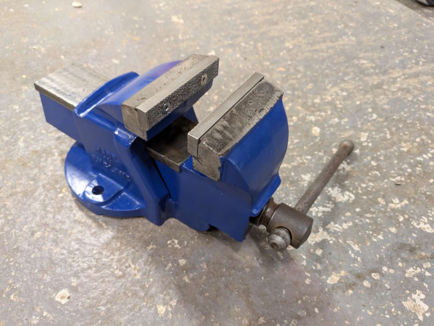

If it’s just worn and ‘patinated’, then spritz with WD40 and go over with a stiff brush then a rag.
If it was like mine was, where it had been slathered with all sorts of grubby paints of different types, so the paint was filthy and cracked, I put a wire brush on a whizz wheel, protective glasses and stripped all the crap off then hand painted it with Hammerite blue, which is as close as makes no difference to Record blue.
Been a while, so I’ll post the photos again…

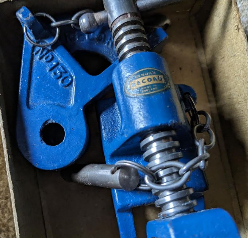

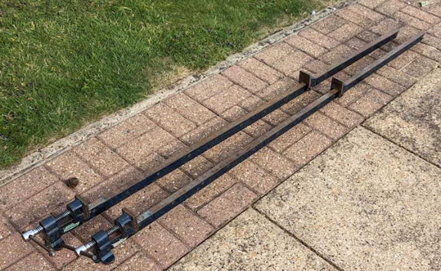

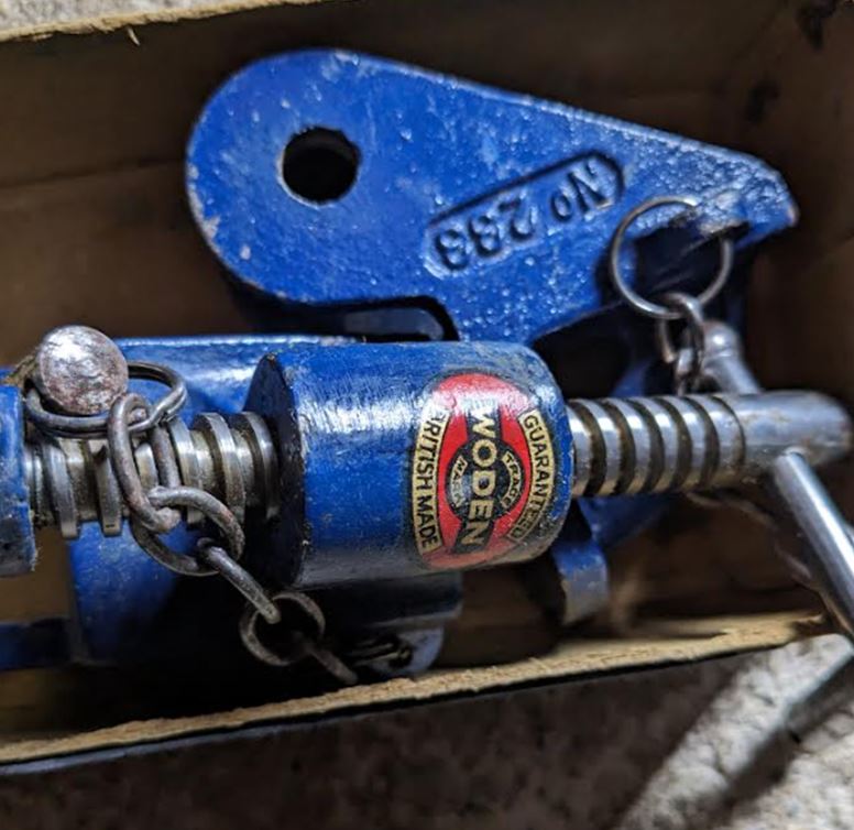

Heres a different angle on grippy things / vices
This is about a pair of 1.7m sash cramps.
[url= [/img][/url]
I bought them cheap but well used from a one man band local Tool Hire company
He developed an aggressive cancer of some sort, and he had to quickly close the business and sold all of his equipment off.
It must have been mid to late 90's.

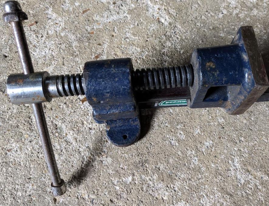

Anyway, the screw threads were pretty worn in both, one worse than the other.
[url= [/img][/url]
I have used them a few times over the years, and got them out recently to use when making a small pet enclosure, and really struggled to clamp up tight.
Decision made, got to do something to repair them.
Immediately I found the problem.....the attached label said 'Made ln India'...

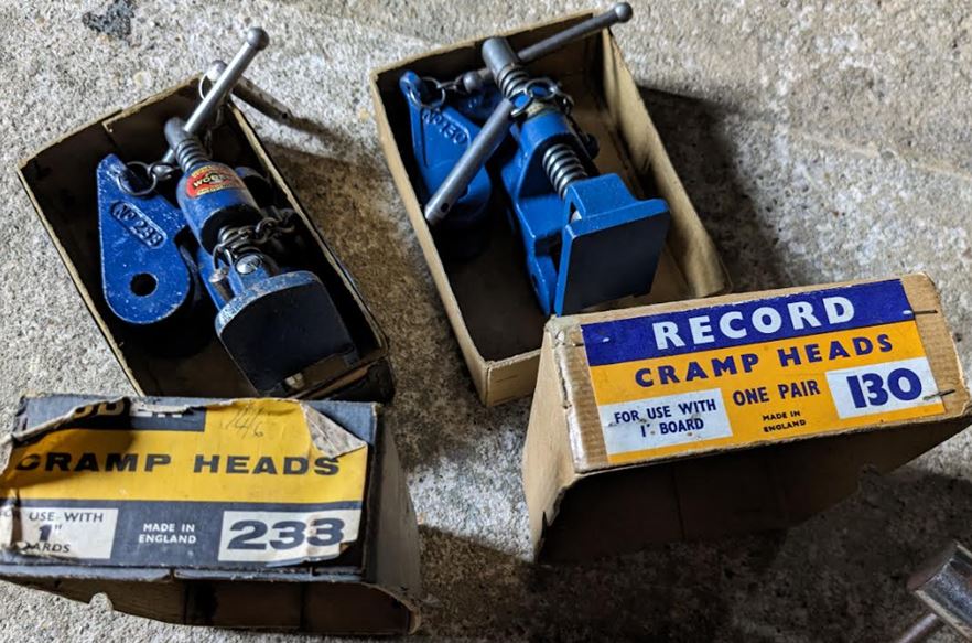

I remembered that you could once buy just the heads to use on timber 1" x 2".
Well you can still buy them, at a price, and probably made in China.
Did a search on ebay and picked these up:
Original boxes as well.
[url= [/img][/url]
[url= [/img][/url]
[url= [/img][/url]
Made in England
It said used, but the Record heads appear to be unused, and the Woden (that business eventually became bought up by Record anyway), just shop/old age marks.
The Indians must have copied the dimensions of these heads as they are almost a direct fit.

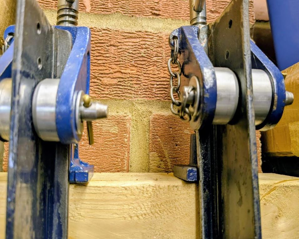

I planned to keep the existing sliding head, but remove the fixed head and replace with the Record and Woden head.
The web of the 1.7m rail is approx 1/4", so I turned up 2 x 3/8" thick alloy spacers to fit either side of the web to make up to the 1" that these were made to fit, drilled through for the locating pin.
[url= [/img][/url]
I now have a good usable pair of long sash clamps.

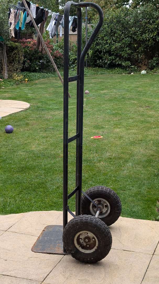

Right, as this thread is starting to drift into useful tools that aren't entirely vices, picked this nice sack truck up from the reuse shop at the tip today. Needs a puncture repair and wobbly wheels want fettling, but solid for a tenner. Not good enough for a dedicated thread though. PXL_20250830_121018383.MP.jpg
Posted : 30/08/2025 5:59 pm
Posts: 13916
I'm probably wrong but I thought sack trucks have a curved back 🤔
Anyway, looks great and one of those nice little repair jobs to bring it back to full functionality.
Nice underwear btw 🫣
Posted : 30/08/2025 7:00 pm
Posts: 5626
That there sack truck does have a curved back. Zoom in and you can see it.
Posted : 30/08/2025 8:06 pm
Posts: 13916
Posted by: bigblackshed
so it has!
Posted : 30/08/2025 10:10 pm

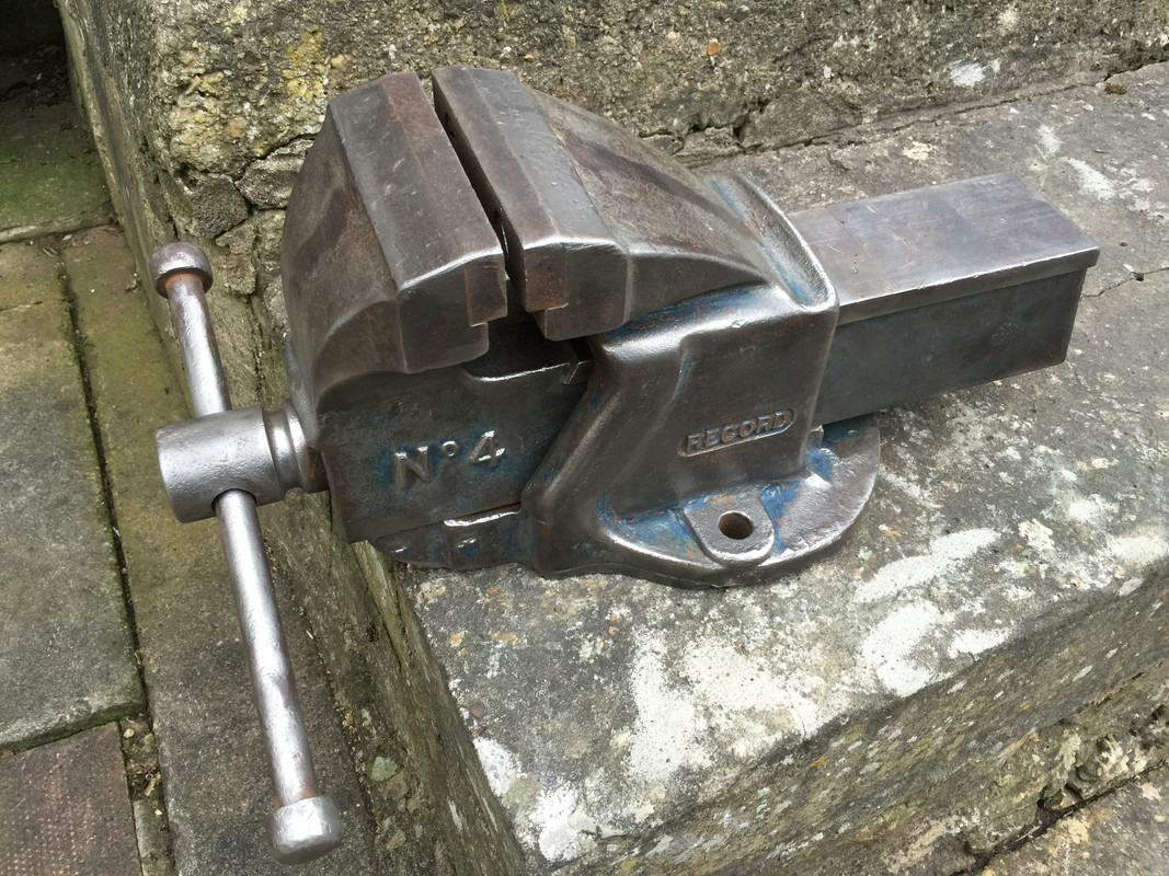

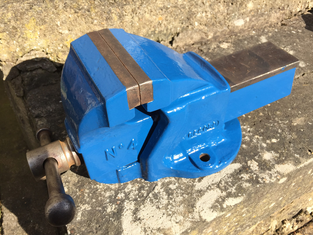

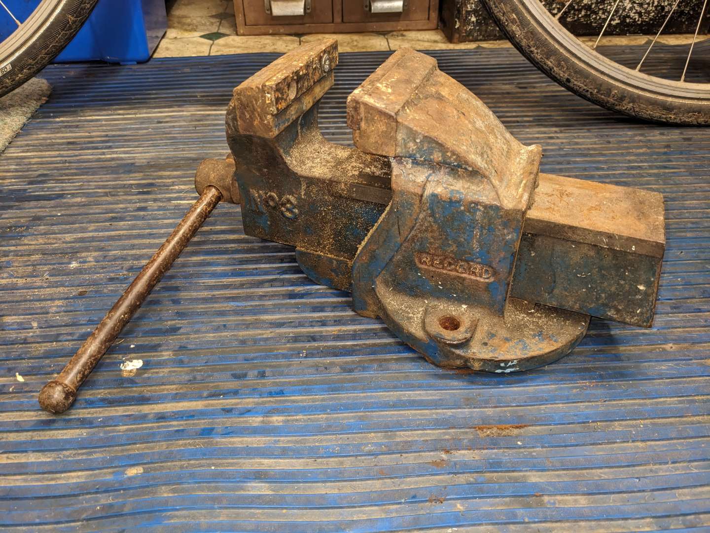

Sadly I didn’t think to take a photo of my Record when I got it, it was in a real state, a very grimy reddish black/grey, the paint was so thick it was a bit difficult to tell it was a Record, but after using the whizz wheel wire brush, it looked like this:
Then, after carefully brush painting it:
With hindsight, it would have looked good with a squirt of WD40 and a wipe down, but whatever. 🤷🏼‍♂️
