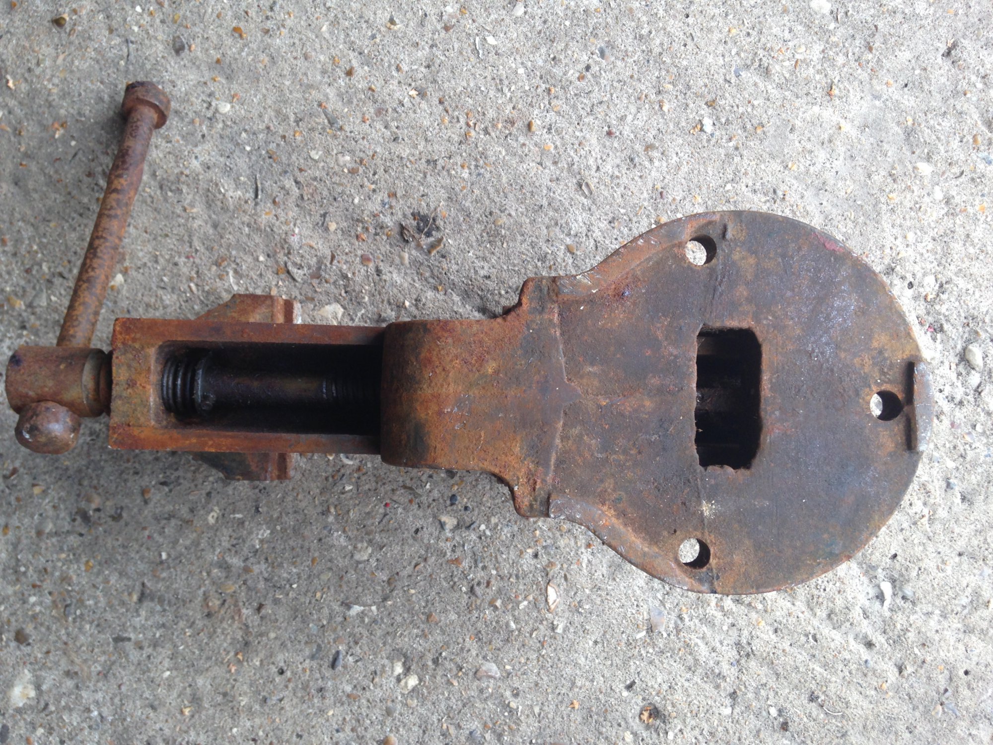

Had a closer look of it this evening. It's a Record no3. I'm curious about how to fix it to a bench. The underneath looks like this no2 on mig welding forums looks like it's meant to go onto something, do you know what? I plan on fixing it to a wooden bench so could maybe just pad it out with an extra bit of wood or something, or, just bolt it and not worry?
Posted : 14/01/2021 8:27 pm
Posts: 91
Just bolt it down. It’s doesn’t need any other material between the cast base and the bench
Posted : 14/01/2021 9:37 pm
Posts: 960
@sirromj I imagine the tab/sticky outy bit on rhs of your photo goes up against the front edge of your bench.
Not sure, though.
Edit
Bunkum, take no notice of me.
But yes, that'll tend to tilt the vice.
Posted : 14/01/2021 9:48 pm
@sirromj
Get some nice carriage bolts to mount it and try to have the back jaw over the edge of your bench.
Posted : 14/01/2021 10:33 pm
Thanks thought perhaps was over thinking it.
I have some M10 coach bolts to hand and fancied the dome part of the head on top of the vice but holes not large enough and of course there's the other problem with that idea.
Will probably sit on 2 x 18mm MDF bolting through 38mm CLS but think the bolts are only 100mm so might need longer. Plenty to do building bench yet though. Not sure how well my design will work out for mounting a vice didn't really think about it when starting, but will find a way.
Posted : 14/01/2021 11:29 pm

It's time to start the renovation of my Victory #3 vice;
IMG_6653
I don't have access to a media blaster, what's the best stuff for removing all the old paint? I gather NitroMors is no longer the shiz...

Just clean it, it looks fine.
Posted : 01/04/2024 4:42 pm

WD40 will get rid of the old oil and muck, if you really want to repaint it a flap wheel in an angle grinder will take the paint off. I haven't bothered with mine, I like the patina.

Yeah just clean it, mine looked like that when I got it. And to be fair it still looks exactly the same
Nice little record. 50 years old

Nitromors seemingly works better if you wrap it in clingfilm and leave it. As said though, unless it's down to the metal I'd leave as is. Blasting does no favours to the sliding surfaces if you don't protect them either.

You can buy dichloromethane, which is the active ingredient of old nitromors, pretty cheaply, but it's terrible to work with in liquid form, presumably you can thicken it but i don't know what with. I experimented with sugar and that kind of worked. Or dichloromethane based strippers are still available "for professional use only". Evil stuff but it works great.
TBH though I might be tempted just to wire wheel it? It's a pretty simple shape, you should be able to get into most of the nooks.
