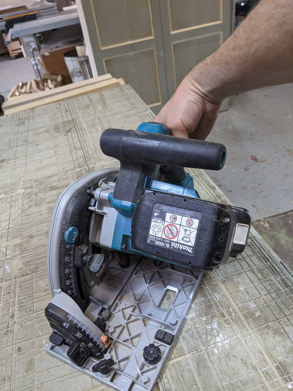

Can't say I've ever noticed them for sale handed.
Mine is like this and I'm right handed.
I guess thinking about it, it is right-handed.
I use both sides when I use the fence attachment, but I guess I mainly run against a straight edge on the left side, largely because the motor body may foul on the right.
Track saw is opposite.

For small cordless saws I prefer them with the blade on the left - they are the kind of saw you'll more likely use freehand to follow a line rather than work to a clamped guide -  and its just easier to see what the blade is cutting (if you are right handed) and the blade isn't obscured by the body of the saw
Conventionally they usually have the blade on the right  - largely because saws tend to throw all the dust out on blade side so (if you're right handed) are throwing the dust away from you rather than straight into your pockets

Is that a map of Manhattan on your bench, Kayak?
Posted : 15/07/2021 3:13 pm
No, Milton Keynes.
