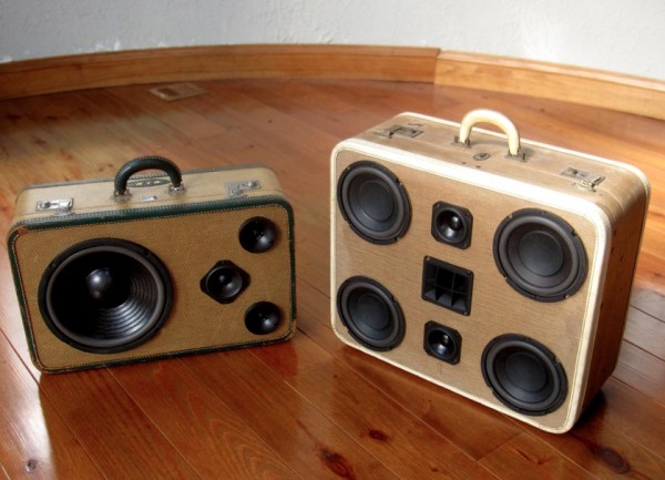

This is one of the projects I have in mind, If I ever get the house finished. My plan was to use one of these amps.
[url= http://www.ebay.co.uk/itm/Hi-Fi-2-1CH-Stereo-Audio-Amplifier-AMP-Super-Bass-HX-168A-with-AC-Power-Adapter-/380724772807?pt=UK_AudioTVElectronics_HomeAudioHiFi_Amplifiers&hash=item58a4f6ffc7 ]amp[/url]
along with an ipod dock
to hopefully end up with something like this.
as I found I could not bring myself to buy one of these.
Posted : 08/03/2014 10:52 am
