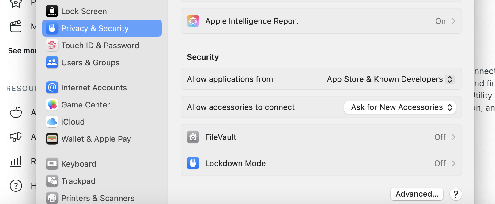

When attaching an external device there is sometimes a pop up which asks you to confirm whether to allow this device to connect. I read recently that sometimes that pop up appears and disappears before you can read it let alone click on it. The fix may be this:
In system setting go to "Privacy & Security", scroll all the way down. Change "Allow accessories to connect" to "Ask Every Time".
You can also use Disk Utility to check if an external drive is loading.
Also for years there have been tales of USB cables only working one way round. I have resolutely refused to believe this but I have one audio interface which will only connect with the cable a particular way round!!. So, er, go figure.
Oh - I'm on 15.3.2
Posted : 28/04/2025 1:07 pm

Thank you slow old man, I have made that change but not had chance to check yet. The disk utility confirms that the garmin drive has mounted, but it doesn’t show in finder or the desktop. Cable to link the two has different ends so I can’t get it wrong! Hopefully the way round that your audio cable works is the way round that it sounds the best 😉

Posts: 1368
@slowoldman success with your suggestion! It works now, so thank you.
