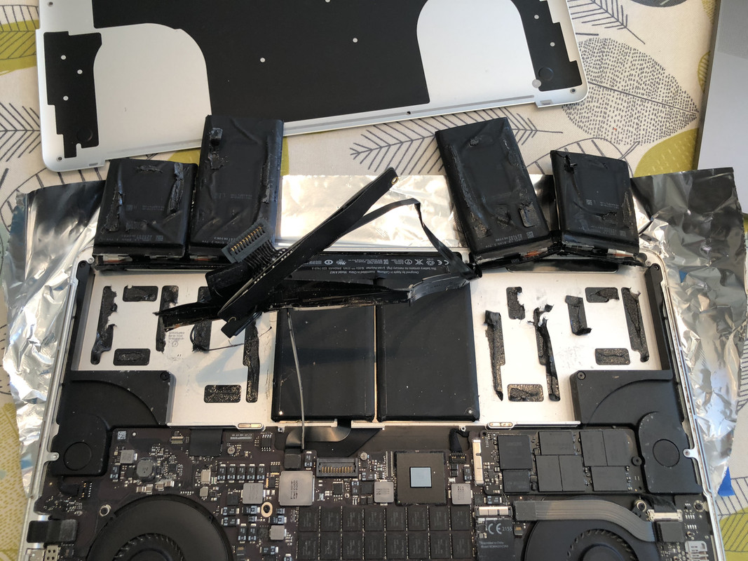

if that fails, I replaced (and transferred the usefulness of) our 15" 2012 MacBook pro with a battery and kit from ifixt. Couple of exciting moments in the process as per below, but turned out OK. 9yrs old and still trucking like a champ.
