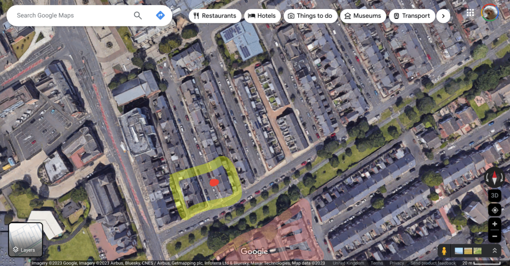

For reference: My house is the red dot, the yellow area is what is still affected in my street, pink area at the bottom is what was also cut off at the same time as me (that I could see). No idea if they still have issues, might go and knock on a few doors later. The rest of my street was not affected by the cut at all, or since.
Screenshot 2023-10-31 10.03.26

It shouldnt be that difficult to narrow it down in that area - I had assumed from your first post you were talking about a much more spread out/rural type affair.
Go round your neighbours, have a word with them, get them all to complain/chase the issue. Power in numbers.
Or as above, get everyone to turn their ovens, hairdryers and fan heaters all at once and see how long it lasts!

The one in three houses thing is to do with how three phase distribution is brought down to two phase domestic supply. Most streets will have three circuits with roughly every third house typically sharing a circuit.
I’d be insisting this be treated as an outage if it was my supply.
Posted : 31/10/2023 10:33 am
Posts: 519
Just about to post that, sounds like one phase is down. They should know this if that's the case.
