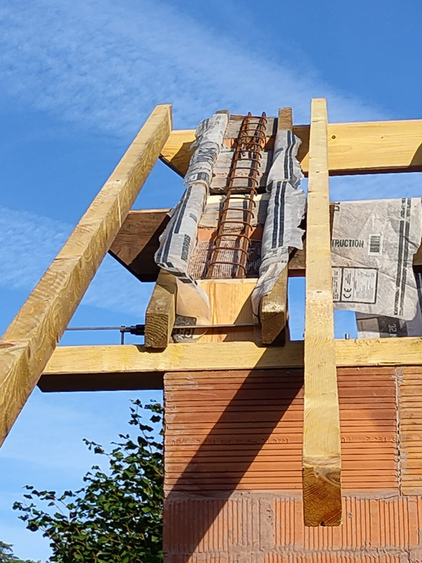

When edthecarpenter talks about trapping the wall between timbers - you can see a timber either side of my gable that do that in this pic taken before the concrete was poured:
We've in a seismic zone so the gable has reinforced concrete up the middle and over the top. The roof timbers are screwed/bolted together and onto the walls. You can also add cross members to triangulate the rafters - I haven't done this as the gable is only 1.7m above the belt of reinforced concrete around the top of the wall.
