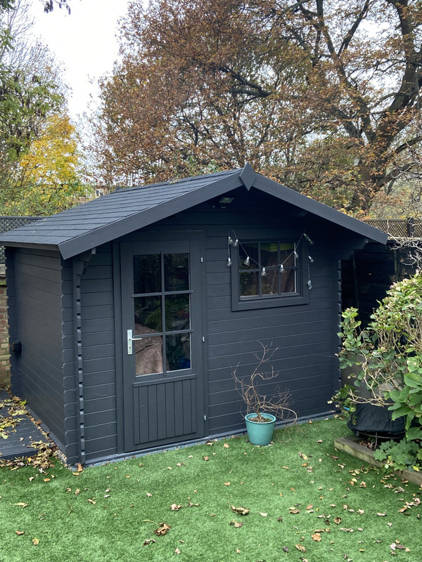

I have a dunster 3mx3m shed office in my garden which I made in spring.
I went with the 45mm wall thickness, and paid for the underfloor and roof insulation. For the cold weather so far it's been fine, takes 45 mins to heat up each morning with an electric radiator then holds the heat well. In the summer if its in direct sun then it does get hot.
Mine is on a deck, but as above you want to make sure its not sat in a puddle, either by raising an area just smaller than the shed, or you can add guttering to run the water away.
I took it easy and built it with a mate over a series of half days, its definitely a 2 man job, but at a push you could get the build done in one long day I would think.
Posted : 18/11/2021 4:17 pm

In the interests of reinforcing my post, above, this is the result of our labours:
Cabin 1
Cabin 2
 Cabin 3
Posted : 20/11/2021 5:34 pm
