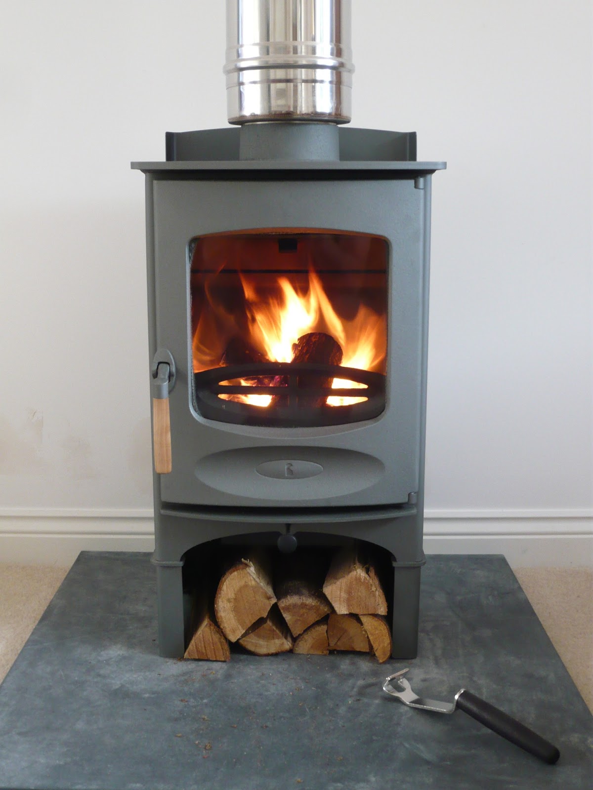

We just got a charnwood c4...again, this is modern enough for us but you may be a lot cooler.
