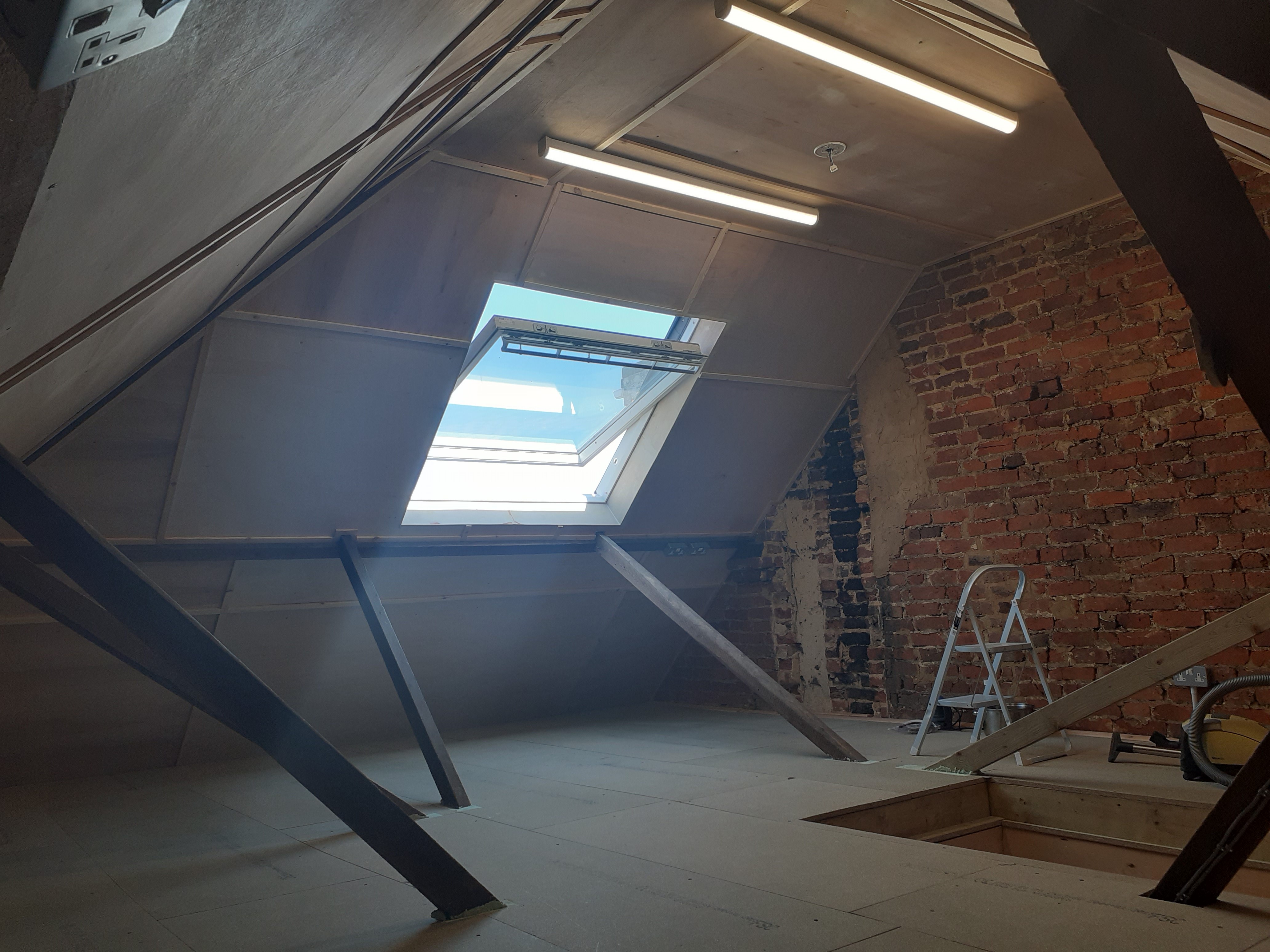

Hi just to update this. We went ahead with the loft room. Thanks for the advice - we went with 75mm rather than 50 mm of insulation, mains fire alarms and putting the insulation below the rafters to maintain the air gap under the roof for ventilation. We also added a few extra sockets. Thanks everyone - we are dead chuffed with it. It came in at £9500.
https://ibb.co/3B4Hz24
https://ibb.co/c3cLn0q
< https://i.ibb.co/YQ7Zsmg/20200731-112845.jp g" alt="" />
Posted : 31/07/2020 11:45 am
 Sui
Posts: 3107
I've done a lot of this on my house as it's a Chalet, can i suggest something slightly different which has proven to work.
Use either cellotex (or other) PIR or Knauf Earthwool Acoustic in between rafter, but then put Superfoil SP19 or better accross the rafters, batten and then plasterboard. The superfoil stuff works brilliantly, my whole house is covered in a duet system of it, then packed with acoustic insulation (which has thermal properties) all to new build standards. It's cheaper and does a good job of reflecting heat during the summer, and keeping it in in the winter.
Ref floor insulation - other than acoustic - why? you want some heat upstairs, why stop it unless you are going to have separate rads?
Veluxs are also easy to install!!
Posted : 31/07/2020 12:20 pm
Thanks Sui
Good advice but a bit too late now, they finished a couple of days ago!
I they preferred to go over the rafters as it was a lot quicker than cutting it in and also less likely to leave gaps. The idea of using the superfoil, sounds good, I kinda considered it but it all came down to cost. With the sun beating down on it today, it is not noticeably hotter than the rest of the house.
Yes, I am not sure why we bothered adding more floor insulation. They were raising/reinforcing the floor anyway so that that floor was is not supported on the ceiling joists. Rockwool is cheap enough that we thought we might as well put it in. I guess it will insulate the rest of the house marginally better with the hatch shut.
Posted : 31/07/2020 12:36 pm
 csb
Posts: 3288
What is going on with those jutting out purlins?
Posted : 01/08/2020 8:55 am
Sorry CSB, missed your message. It would have been nice to reposition then. I think we would probably have needed a structural engineer to do so. I think the solution would have been to put some steels in spanning the walls to support the roof lower down. From the sound of it, it was going to add a few grand to the cost.
It is not too bad in practice, the Perlins divide the room into useful sized bays.
Posted : 14/08/2020 7:23 am
