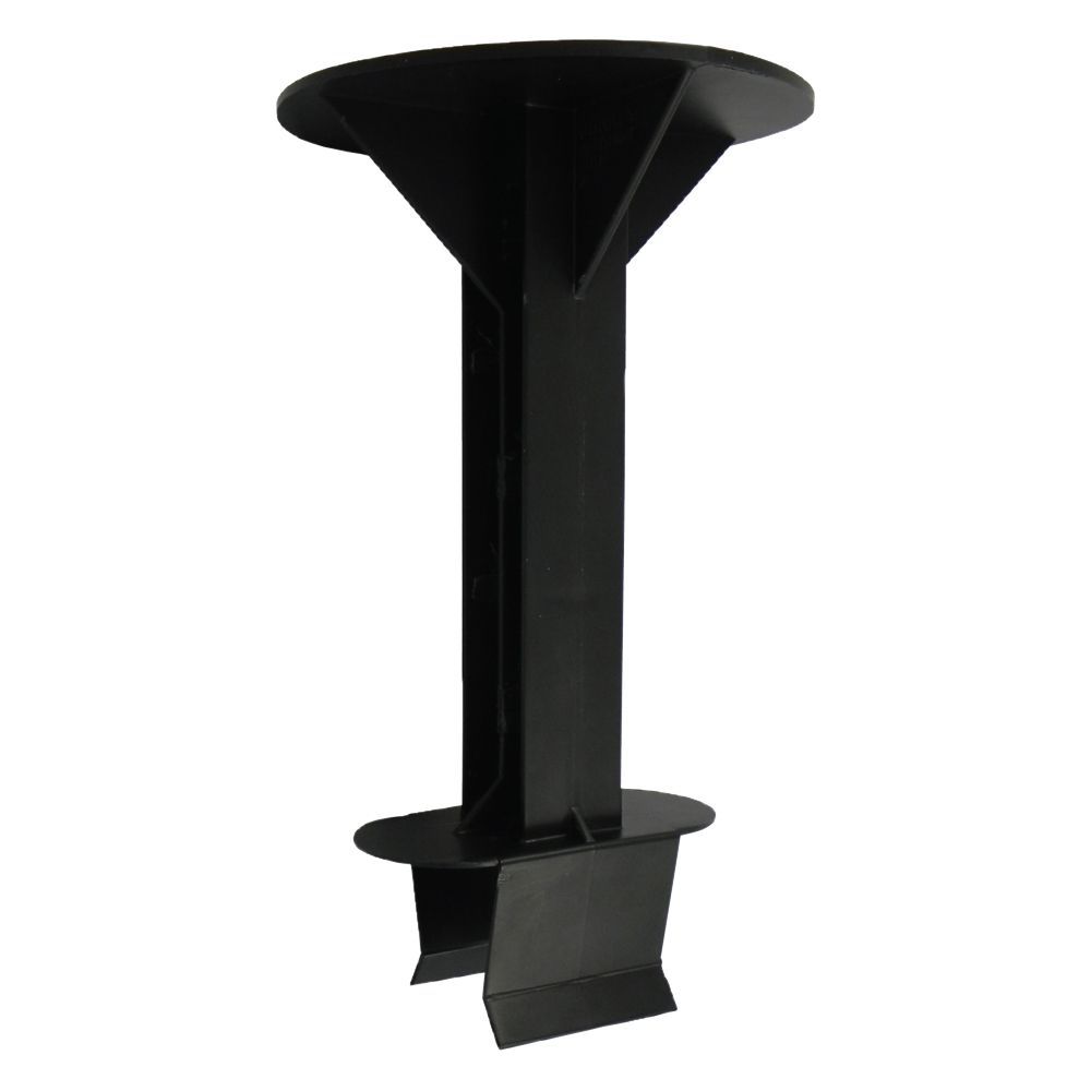

others ive seen are clip on things that look like deathtraps.
Do you mean these ones?
[img] http://kingfisher.scene7.com/is/image/Kingfisher/04074212_01c [/img]
As you're still meant to screw them down
Posted : 23/01/2015 5:17 pm
ah. i struggled to see a use for the clips as the genuine loft legs are screwed down, so assumed these were clip only. a little naive in hindsight 🙂
Posted : 23/01/2015 7:03 pm
