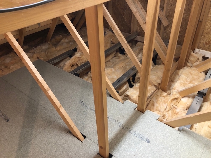

I've been considering boarding our loft for a while, but I'm not yet satisfied I've found the right solution. We have raised tie trusses like this:
(Our bedroom is in the roof space under the horizontal tie)
For ease of installation, I was considering the Loftzone kits. However the legs of these won't fit under the diagonal ties (or are they struts?), until quite far out towards the edge of the loft space. So if we want to board right across we need some other solution in the middle (or perhaps overall). The Loftzone kit would look like this, but with a larger span in the middle between the metal beams. Our diagonal ties are shallower than these
Can anyone provide any ideas? I asked Loftzone and all they suggested was their kit with shorter legs, however this will compress the insulation we have and there will still be large-ish span in the middle.
Could I hang wooden beams off the vertical and diagonal ties to support the boards in the middle? Also I've not measured where exactly the Loftzone kit will fit. If it ends up too far towards the eves then it may be pointless as there is little headroom there

I've seen those other systems. I'll still have the same issue with them though. Loftstilts seems a cheaper system but you need more supports than the Loftzone. I'll have to look at them all in more detail for cost and install time comparison. If Loftzone is a lot quicker I'd be happy to pay more as I hate working in the loft!

Good points timba. I've measured up the trusses now. It's not worth having the Loftzone kit. The space under the diagonal struts where there is 300mm clearance to fit the legs is only 600mm wide. The Loftstilts or Loftleg would be better value.
Then I just need to make my own supports where the diagonal struts are and in the centre.
