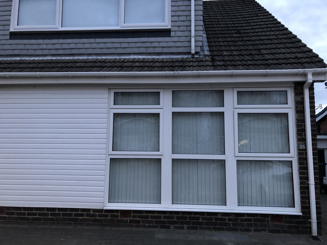

We’ve finally ordered a new window for the front of our living room after noticing the seals were so badly blown the wind was moving the blinds (!).
Anyway, when the fitter came round to take the measurements he noticed the two wide vertical sections between the glazing (see photos), something I hadn’t noticed before myself. He said he expects there is a lintel of some description above the window.
He seemed pretty chilled about it and noted a lot of the other (identical) houses around had had their windows replaced with modern units without the wide upright bits..
Other than find out what’s above the unit on the day he tips up to fit the new window is there any way of checking? Are load bearing windows a thing (1963 house)? I don’t want to make any assumptions when it comes to the structure of my house.. does any have any tips or pointers please?
Cheers
[url= https://i.ibb.co/kqK9JFW/8-FE0-B3-A6-8709-4683-A3-B1-741-FE6-B698-CB.jp g" target="_blank">https://i.ibb.co/kqK9JFW/8-FE0-B3-A6-8709-4683-A3-B1-741-FE6-B698-CB.jp g"/> [/img][/url]
[url= https://i.ibb.co/wK52wPB/8-BDB7-D28-0931-4149-8285-D20-AAF9-EDA1-F.jp g" target="_blank">https://i.ibb.co/wK52wPB/8-BDB7-D28-0931-4149-8285-D20-AAF9-EDA1-F.jp g"/> [/img][/url]
[url= https://i.ibb.co/SXjRxQj/FD50108-A-66-D4-44-F7-8-CA9-F4983133-F272.jp g" target="_blank">https://i.ibb.co/SXjRxQj/FD50108-A-66-D4-44-F7-8-CA9-F4983133-F272.jp g"/> [/img][/url]
[url= https://i.ibb.co/X3QZn8w/71-D5-AAE4-EADC-40-AA-B553-E4-ECA2692-D29.jp g" target="_blank">https://i.ibb.co/X3QZn8w/71-D5-AAE4-EADC-40-AA-B553-E4-ECA2692-D29.jp g"/> [/img][/url]

Can't imagine a window wanting to take any load, the roof of your house is loading the inner skin of the house well it does in Scotland, there should be a lintel of some kind on the inside
Strange the English style of sticking a window right out of the buildings
Posted : 07/04/2021 8:44 pm

There are old building where the window frame does carry some load/is structural. Can’t see the photos though?

The window and frame will never be load bearing. Well for new UPVc anyway. Old timber windows did take some load. The loads from the outer skin will need to supported on a lintel or angle iron.
Can't see you pics though so no idea what yours are doing...

Did he mean no lintel above the window?
There is a row of houses up the road from me that have a half bay window. 3 of them had have the wall above the window rebuilt when the old wooden windows were removed, as the wooden frame was load bearing.
One was bodged, held up by acrow supports, and a plain upvc window put in, this window wasnt strong enough, and is sagging in the middle now, with cracks in the brickwork above it.These houses definitely needed the extra support bars fitting in the windows, to support the bricks above.

There has to be a lintol on the inside skin taking the weight of the roof and the former
The window if it's sitting on the outside skin might be carrying a couple of courses of brick that the facia is attached to but no other weight

I've experienced older bay windows in England where the windows took some load from the lintels above, and more modern timber casement windows where the frames were loadbearing. The solution adopted by the aluminium/upvc window installers was to inset telescopic props (like slimline Acrow props) between the window frames, crank them up to take the load, then conceal them behind pvc trim.

There are structural elements that can be fitted between windows that take a load, especially in curved bays windows. There will be a lintel in the above pictures, whether it needs additional support would depend on the type.

I'd be surprised if that window is taking any load, the roof will probably be supported on the wall plate that will span the window. There's bugger all above that window, no brickwork anyway, so won't be any load passed through the window.
Probably.....

The only real way of knowing whats there is to expose it, either by taking the window out, maybe removing the soffits or if you have access into the eaves through the bedroom above see if there is timber spanning the window gap.
It doesn't look that wide, I've got 2.5m wide windows in my house that didn;t have any lintels put in when the old timber windows were replaced years ago. the brickwork above was a right mess, cracking and sagging. We've just had all ours replaced as part of a bigger renovation and had the builder install lintels in upstair windows and steel angle irons behind the brickwork in the downstairs ones along with heli bars in the brick work above...
Your roof will not fall down if you remove that window. Infact on closer inspection theres a trim at the top of the window that might show if theres a lintel or timber behind it if you, or the window fitter remove that.

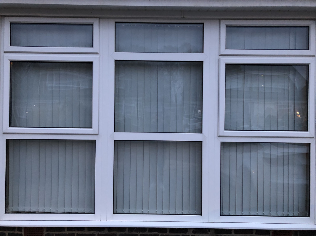

The window is 3.5m wide. On closer inspection on the inside it looks like there is a timber spanning what would be the inner leaf at the top. Window fitter is coming back out this afternoon so I'm going to ask him to try and remove some trim/fascia and see if he can see anything. Thanks
Saw that being done on a bay window in our street the other week, super thin props about 1" wide maybe, just hidden between the three window panels.

I think there is a good chance that the frame is loadbearing as the posts in the centre look quite big and there looks to be very little height above the frame for a lintel spanning clear across.  If you can strip away inside the timber to the top of the frame will either look 'chunky' (probably okay), or 'skinny' (probably not). Your fitter should be able to tell by eye.
As others have said this is common in bay windows and I've seen them slowly collapsing when replaced with UPVC without props.

Yeah this is what really worries me, that there's a couple of timber posts in the centre holding something up above them.. My neighbour over the road has had his done recently so I'm going to try and collar him and see if he can offer any insight.

If that opening is 3.5m wide there must be either a fairly substantial beam above it or smaller beams (lintels) supported on posts between the windows. At the very least there is likely to be the roof load and quite possibly the upper floor too. I would be asking the window installer how they would be investigating that and what measures they would put in place depending on what they find. I would also want to see the structure exposed before they fit the new windows and cover everything up.

Solid advice, thank you. Fitter is coming at 5pm today so I’ll be asking him to remove some trim and go from there. I’m pretty much the last house with the thick posts between the windows, some have bricked up the bottom half, put a small bay in, etc. I’m waiting for the bloke over the road to come back from work so I can badger him about it!

Update: Fitter came round earlier and removed the trim above the window to reveal a single very large piece of timber spanning the entire 3.5m. There is nothing in the upright post sections of the window coming up through the top of the unit and supporting the timber.
The fitter had spoken to a builder who had done one recently in the area and said he expected that's what we would find. I wanted to see it for myself though. Thank you for the tips and advice above all - much appreciated.
