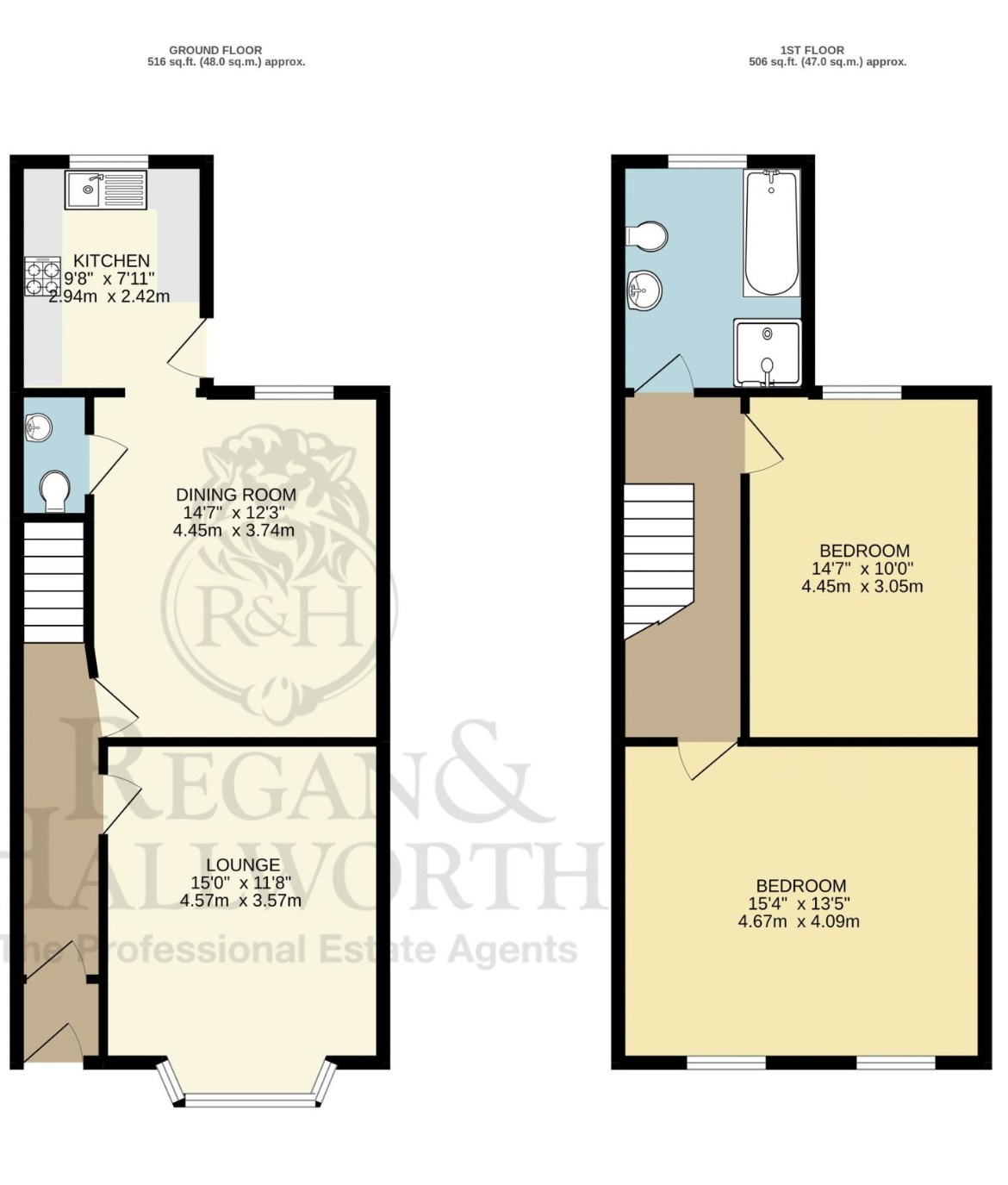

I have a 2 bed Victorian terrace, with the floor plan below

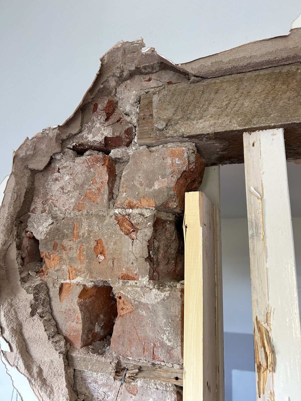

I had an arched doorway going from the dining room into the kitchen. I started to remove this to square it back off, and found a wooden lintel that’s barely resting on anything

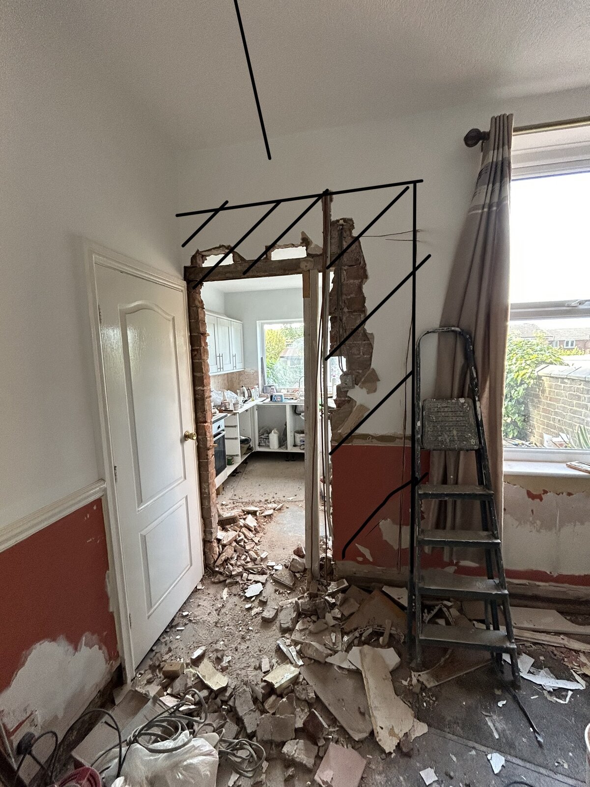

I’m thinking of now opening this up further like this
My question is, would a 100mm x 65mm concrete lintel suffice? It would be 1800mm in length and have 200mm extended beyond the opening either side.
Something along the lines of this? - https://www.diy.com/departments/expamet-concrete-lintel-l-1800mm-w-100mm/150792_BQ.prd

I'd say no. I was planning on doing something similar to a house of nearly the same layout, got a structural engineer in for ~£350. I am usually very much a work it out my self type person but thought being as I will want to sell the house I would make sure I have official calcs done. If I was going to just do it without calcs I would be using a universal beam rather than a concrete lintel.

As the brick says - I think that would need more than a concrete lintel.  Looks to be a load bearing wall.
Posted : 05/06/2023 9:49 pm
Third vote for get an engineer. Maybe a concrete lintel will be fine, maybe it won't maybe you will need a steel beam. There is no way I would touch that shambles without a proper look over from a proper engineer.
From an architectural point I would go to the same height as the window reveal.

You're also planning on reducing the amount of wall between the existing doorway and the window that will definitely affect things.

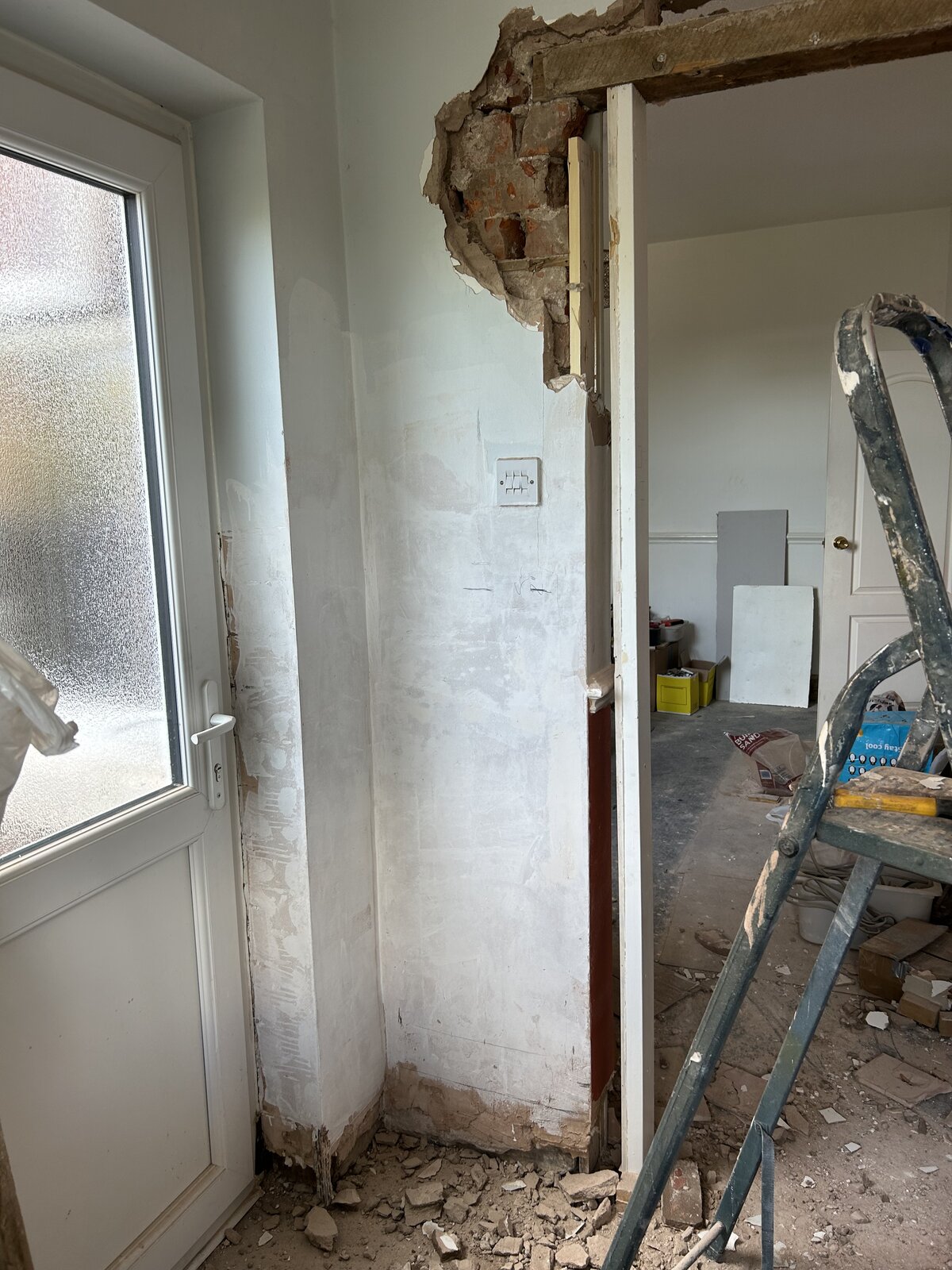

Just looking at the photos again, I presume that the extension on the back is original.
The external door in the extension may complicate matters slightly (as will the high window in the dining room) as it is also quite close to the load bearing corner.
That existing lintel doesn't look very supportive at all and it wouldn't surprise me if the door frame was actually it helping out, so maybe don't take that out too soon!
Both the size of the lintel and its bearing area need to be calculated properly to account for the loads from the first floor (bathroom wall + possibly bedroom floor joists), but without any calculation, I'd say that the concrete lintel would be woefully inadequate.
I think whatever you do, you need to get some acro props under the existing lintel and re-build the supports either side. (i.e. properly build - cut out broken bricks and replace, rather than just 'filling in the gaps'.)
Have a play here to get an idea of the size of lintel you'd need -
https://catnic.com/products/lintels/lintel-product-selector
If you are really keen, you could calculate the loadings yourself, but a SE would be the best bet - essential if Building Control are involved (I think you're *supposed* to inform them about this sort of thing).
ETA:
keep the opening the same size and replace that timber lintel with a slightly longer concrete lintel? (100mm x 65mm)
I very, very much doubt that the 100 x 65 concrete lintel would be adequate.
