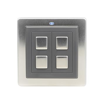

In my head what I'm trying to achieve is the same as putting switch inline at each light, but instead of the switch I'm putting in a rf controlled relay
Therefore what I need to do is bypass the existing switch so power goes the light pendants continuously. Then I need 2 of these, one at each light pendant, with the power bypassing at the first pendant so it supplies the second pendant independently. [url= https://www.megamanuk.com/lightwaverf/products/inline-switching/jsjslw831/ ]>Link<[/url]
[img] ?v=1414610726[/img]
And then two of these to control the relays from different locations [url= https://www.megamanuk.com/lightwaverf/products/dimmers/jsjslw420ss/ ]>Link<[/url]

Actually the switches is wrong, I need two of [url= https://www.megamanuk.com/lightwaverf/products/remote-control/jsjslw221ss/ ]these[/url]
