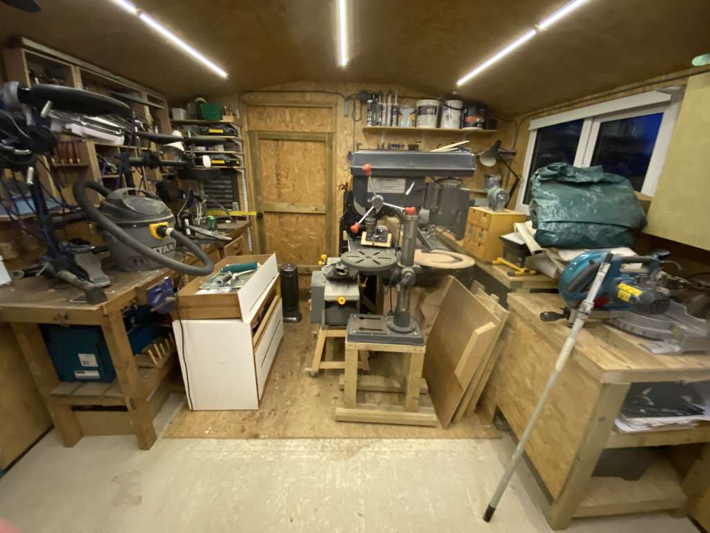

IMG_4847Here’s a random picture of my shed (I had everything pushed up one end in order to paint the floor) but I think it shows the benefits of the long continuous strip light sources. I’ve since added extra strips over the workbenches. It’s a very flexible approach.

Sorry, please read both my posts, but I split it and wasn’t very clear. What you see in the picture are LED strip lights, which are self adhesive tape covered in LEDs just stuck to the ceiling. You can buy them in various lengths with mains power supplies like this:
https://www.screwfix.com/p/bendable-5m-led-tape-light-10w-1200lm/959fx?ref=SFAppShare
I actually purchased the bare strips, and I bought some aluminium channel to fit it in, and I bought one big 100W power supply to power all 12m of LED strip. But if you purchase something like the above 3 times you could run 3 strips off the 3 supplied power supplies. Just trim off excess light strip. I wouldn’t judge brightness from my photo, but the quality of light due to how it’s distributed is excellent.
