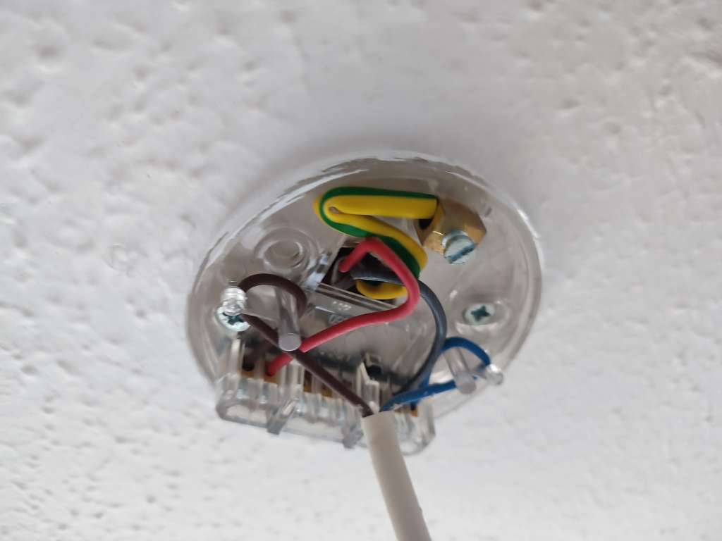

mams moving into a new flat and wants a couple of new lights fitting.  as always, id like to do it myself.
looks fairly simple, but just wanted to check with you experts first.
old light......

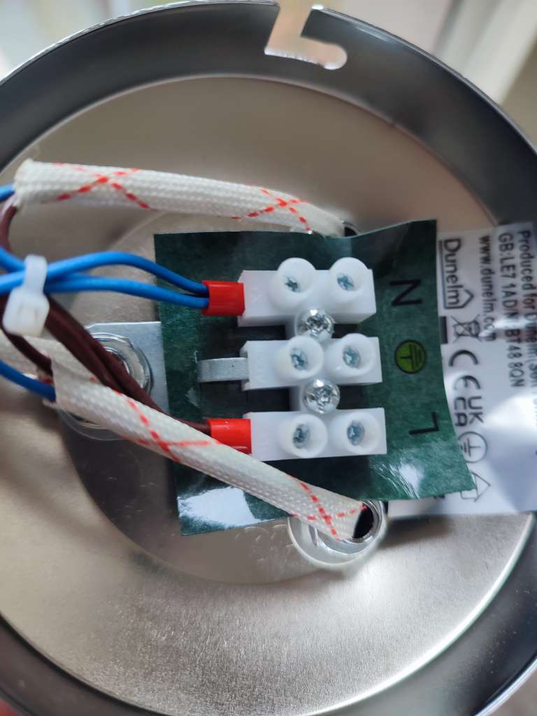

new light......
IMG_20240103_112925
am i right in thinking that its just a case of sticking the red to brown, black to blue, and earth wire in the centre?
the only thing that baffles me somewhat is that the light is switched from two locations, so i would have expected more wires, but common sense says its just a straight swap and it should work as before.
am i correct?

You’re right.
The extra wires may be hidden in a junction box in the ceiling

Yes, red/brown and blue/black.  The switching will be in other junction boxes in the loft.

Yeah, all the gubbins for the double switch is up behind that plate there. You just have a switched live and neutral coming through.
Check it's definitely off before you start disconnecting it though.

Easy enough, assuming the c.p.c is actually connected somewhere at the other end, which you need to definitely make sure it is as it’s a metal light fitting

Yep, check the earth is connected with a multimeter (either continuity back to the main earth with a fly lead or the slightly more dodgy but quicker method of checking you have 240v ish between the live red and the earth) as your new fitting is not double insulated.
The 3 way switching (two switches) can be dealt with either in the ceiling rose, or in your case, either a junction box in the ceiling or just within the actual switches themselves.
