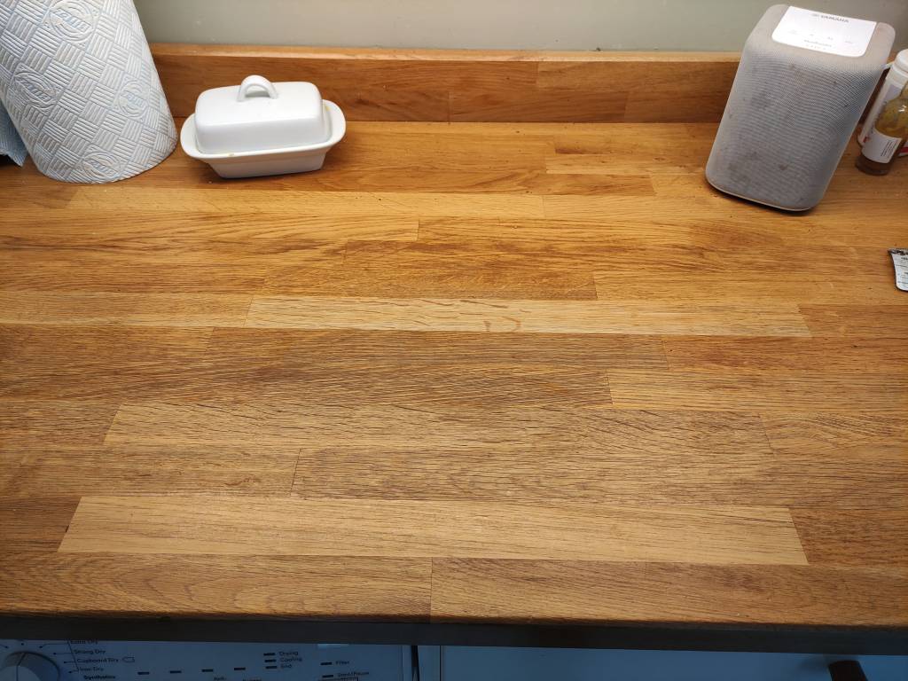

The kitchen worktop is looking a bit tired (don't get me started on what a PITA solid wood worktops are, we didn't install it, but it's there now and we're not changing it).
So, I guess it needs a light sanding down and treating with something protective. I don't know what it was done with last time (it might have been Danish Oil as I found a tin of it when we moved in), but I've heard good things about Osmo?
Let's hear your tips for making this as hassle free as possible.
