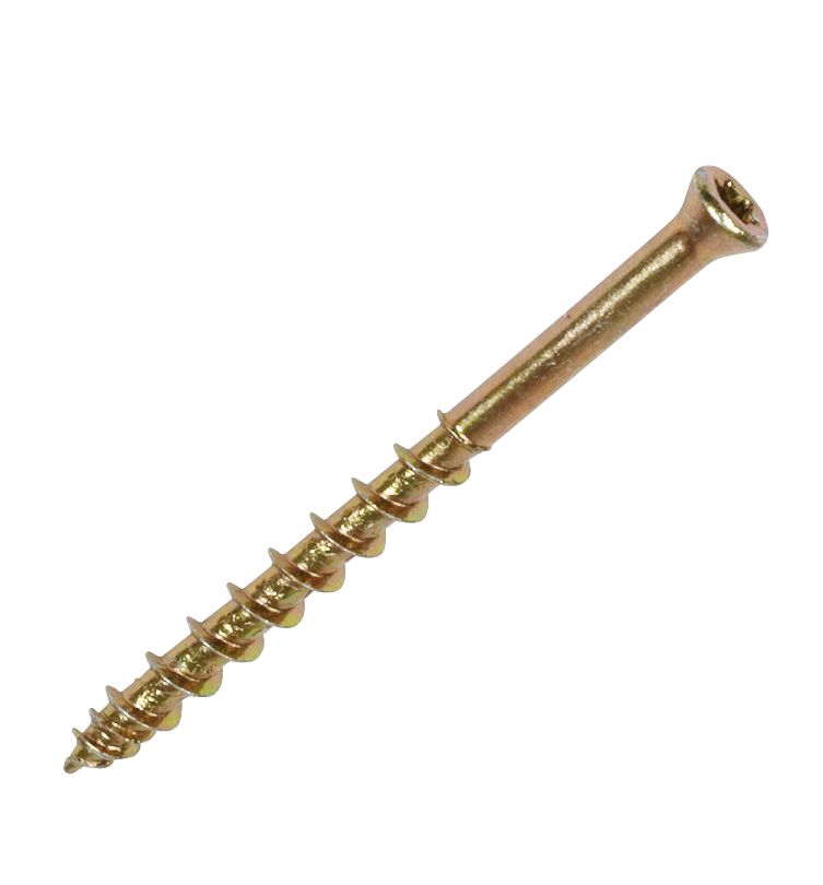

I used these screws, really impressive given how narrow their heads are. They can pull a bowed floor board flat, yet they are virtually invisible once in, but you can still get them out easily...
[img] http://s7g3.scene7.com/is/image//ae235?src=ae235/85991_P&$prodImageMedium$ [/img]
http://www.screwfix.com/p/tongue-tite-screws-3-5-x-45mm-200-pack/85991
